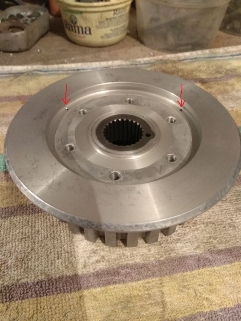

I have similar problems like @shrekster since I've bought my fazer few years ago. I've heard about those popping out core plug, but mine is in place. I have also almost dry friction plates, so I'm thinking about drilling additional holes in inner part of basket. I'm also thinking about improving oil supplay to the center of inner basket, but I'm not sure how oil gets there. Are those marked holes in below photo responsible for oil supply?

Sorry to show my ignorance but is this something that can be done in situ or does the whole clutch assembly need to be removed from the bike?
#23
They used to do that on the fzr1000 with grooves as well for oil flow.
http://www.factorypro.com/tech/clutch_y.html
#24
I wonder if there is a 'howto' guide on this somewhere, as I have killed a set of plates in the past due ti the poor oil feed to the Plates.
