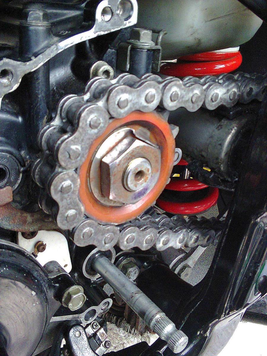

Mine is a 99 though its on the original sprockets. I get the wheels back today after having new tyres fitted so will swap the nut later today and also measure the shaft. Anyone know the correct torque for the modified nut? Standard torque is 70Nm but I've seen on here 90Nm but that might be too much if the shaft threads are shallow in the nut.

(18-09-13, 02:39 PM)TonyW link Wrote: Mine is a 99 though its on the original sprockets. I get the wheels back today after having new tyres fitted so will swap the nut later today and also measure the shaft. Anyone know the correct torque for the modified nut? Standard torque is 70Nm but I've seen on here 90Nm but that might be too much if the shaft threads are shallow in the nut.
A few people have gone the specified 90Nm, and a few others stopped at 80Nm including myself, the choice is yours!!

Nut job done.  Big Grin  The original nut wasn't loose but wasn't as tight as I was expecting. I took the time to measure the shaft thread, it was 17.9mm so chucked on some bearing retainer and the new nut went on at 80Nm.

Been looking at torques and there are only 3 places I am ever going to go over my 60nm so think I will be going for a olwer cost one, thinking if they are not as acurate then no matter as anything 80 90 120nm aint ognna break if its a bit tighter, - unlike somthing that needs to be 20nm.
So ive got my new nut and ys it has an extra 3 threads but look at my picture as I have hardly any threads left showing and what is there tapers so wont be doing anything so by a bigger nut Im not gaining anything.
(18-09-13, 10:40 PM)TonyW link Wrote: Nut job done.  Big Grin  The original nut wasn't loose but wasn't as tight as I was expecting. I took the time to measure the shaft thread, it was 17.9mm so chucked on some bearing retainer and the new nut went on at 80Nm.
Not measured my shaft yet but tony w says his 98 is 17.9, could that be the reason 98s are ok as we 98s have thicker shafts than everyone else
