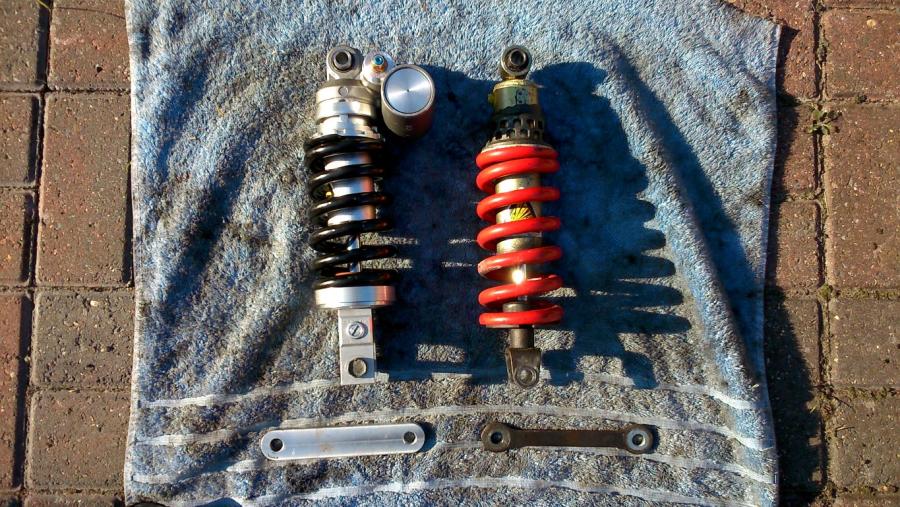

As the 'projection' dogbones still hadn't returned the rear to standard height, I had a pair of bespoke ones fabricated, 127mm from hole centre to centre.
Handling has got better with the slightly raised rear & bump energy transmission is even less than before.
They are 8mm thick & have no taper in order to give extra rigidity. Bit more blingy too, but that unfortunately highlights how grotty the rest of the bike is  :o  I've attached a pic of the rear wheel when the bike is placed on the centre-stand - does this look closer to the ground than standard?
Yes, I have a Thunderace rear caliper fitted  Smile
I have attached other pics of the custom dogbones compared to standard / 'Projection' plates.
Project R6 rear shock now complete.  Big Grin

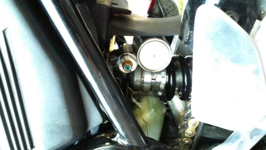

I fitted a R6 shock at the weekend and the past few days I have been putting it through its paces..
I went for a Faulkner 725lb spring and 127.5 mm dog bones..
I am 95kg geared up and to get a rider sag of 32mm I am on preload position 7.
Rebound is set @ 13 clicks out, low speed  @ 13clicks out and high speed @ 2.5 turns out..
The bike feels fantastic, very planted.
The dampening control is amazing!
A big thank you to Kebab and Fuzzy for all there help
.jpg   IMG_20131023_165940_830 (Medium).jpg (Size: 131.62 KB / Downloads: 735)
#30
Dogbones look good, does it get in the way of adjusting the rebound?
Glad it worked out for you too  Smile

(23-10-13, 05:46 PM)Fuzzy link Wrote: Dogbones look good, does it get in the way of adjusting the rebound?
Thought I'd also share my specs and current settings:
  • 700lb/inch spring
  • 128mm dogbones
  • Rider sag 33mm on notch 5 @ 75kgs geared up
  • High speed comp: 3 turns out
  • Low speed comp: 16 clicks out
  • Rebound: 15 clicks out
Still needs more saddle time to test these settings but in any case it's way better than the stock shock.
Hello bud, dog bones worked out well, they don't effect rebound screw at all..
