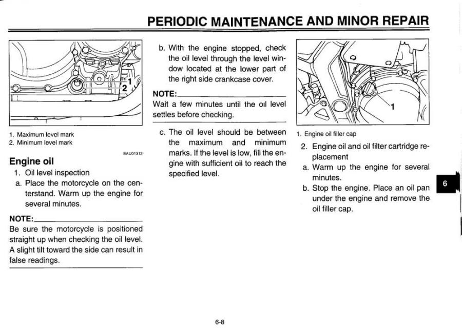

so anyway acting on Fazersharps suggestion (cheers) I put bike on sidestand to check level.
No braille like dots visible but a backplate with two hoLES.
Seeing this it's clear with centrestand the engine is overfilled.  Surely such a mistake will cause serious damage :'(

At a random guess i'd say putting the bike on the sidestand and checking the oil is like someone serving you a pint with the glass at 45 degrees........not normal or acceptable behaviour!
Centre stand (on level straight ground)
Start bike
Leave running for 30-45 seconds
Let oil level adjust for a minute
There's your oil level.
If it's above the higher dot......you focced up.
If it's below the lower dot, discard your egg from your beloved cup and with 50% shots of oil top up as required and repeat the above steps until you are happy.
Clean egg cup with non poisonous cleaning stuff, ie: Fairy Liquid......rinse thoroughly......then reinsert egg and carry on with breakfast......apologising to soldiers for the delay!

Look again grass hopper you look but you dont see-- here are your two dots giving the upper and lower marks

You don't check the oil until you've run and coated the engine first, which is why your egg cup theory is really not a theory at all, 'cos if you were to wait another 20 minutes the oil will rise and rise 'til you can't see a level.
If you are not starting the engine, which is sounding increasingly likely by the sounds of it, then you do not have enough oil in your engine.
Hence the reason your oil light comes on!
When the bike is static, the window will show pure oil.
When changing oil, refill with exactly 2.5 litres, start engine for 30-45 seconds, then wait and watch the oil level rise.
It will settle down after 30 odd seconds, that is your oil level.
If it ain't quite right, then top up, gradually, then start engine again and let settle before checking again.
