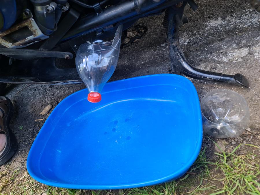

(29-05-25, 11:50 AM)fazersharp Wrote: Changed the oil. Dropped the sump plug that i was using to control the flow of oil so it missed the oil tray under it and oiled my slabs Wall
The cap was on to try and help but the problem on the FZS600 is that the side stand gets in the way of catching the oil. I almost need to put the stand in the tray or someone needs to invent a catch tray with a section moulded around the stand.
Hmmm Idea  I have got a heat gun.

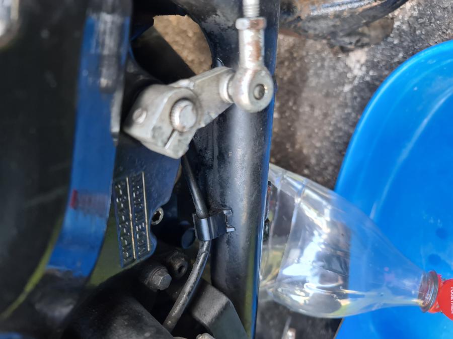

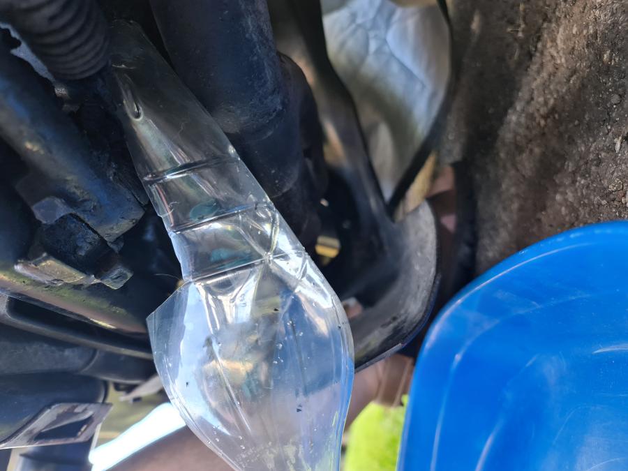

I use an old cola bottle cut in two , use the bottle neck end , and cut half side away, will send some pics when i get chance. Works for me  Smile .

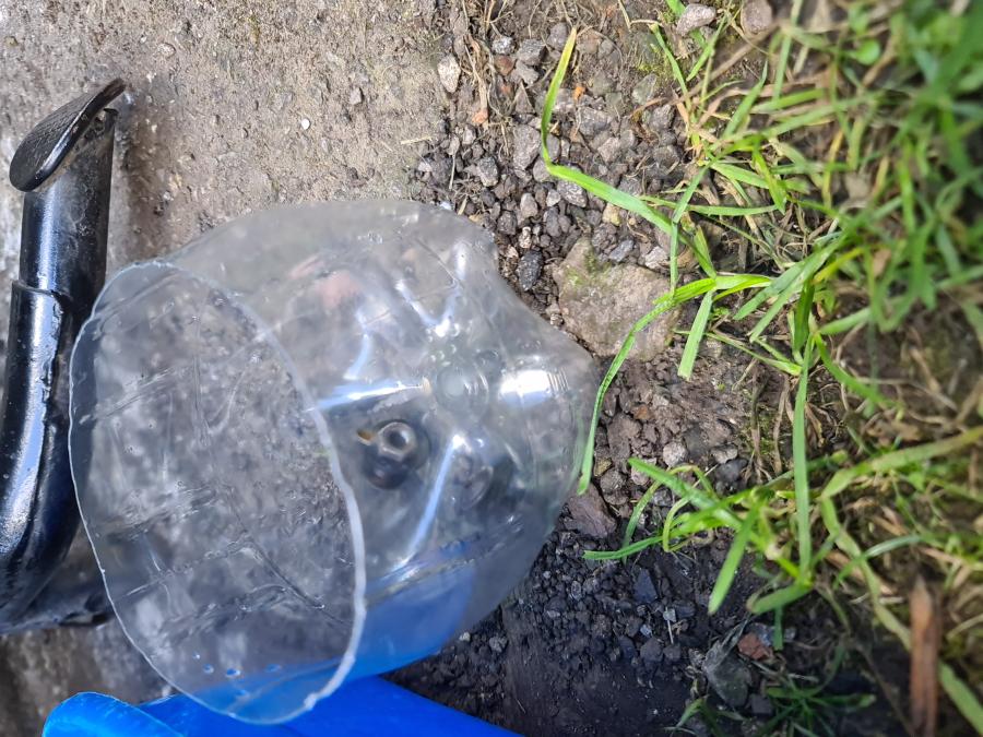

As promised  Tongue n you can use the  bottom for your nuts  Big Grin .
