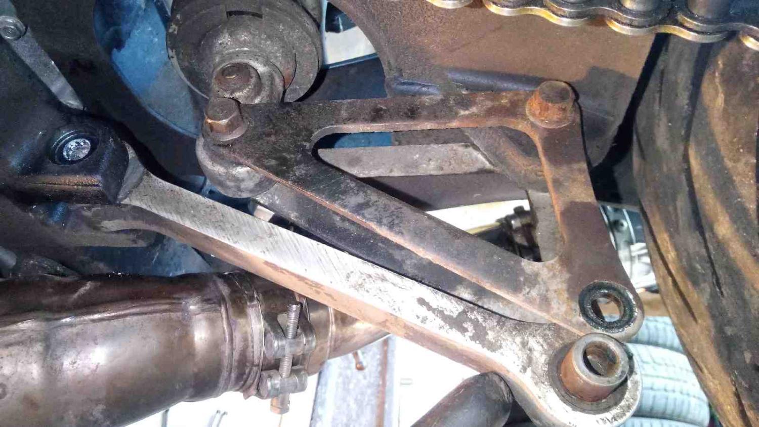

(29-09-21, 03:29 PM)agricola link Wrote: Chuckin down here, so decided on some mancave time. Thought Id start by checking the rear shock bottom linkage is still free, but carried on and also took out the swinger to check the bearings etc. The swinger was fine so cleaned and re-greased, the bottom shock pin can out dead easy as Ive had it out to grease it up every couple of years, but there was the smallest amount of play between the collar and the bearing so I've ordered those two items plus new seals, Swinger is back in, exhaust all back on, body parts back on, waiting now for parts delivery
Inspired me to do the same on my Gen 2 FZ1 today - the bearing at the rear end of the dog bone link was shot - Corroded and most definitely in need of replacement. I took the opportunity to paint the triangle link plates and cleaned up the shock whilst they were off the bike.  I will need to reassemble with the shot bearing to make room in the garage whilst awaiting the parts delivery.
