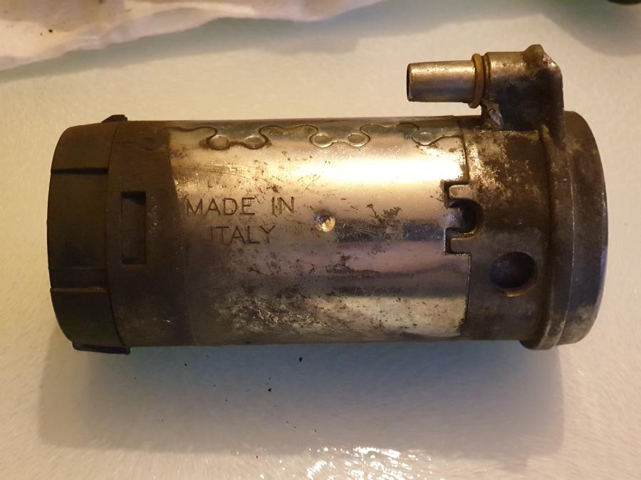

(13-12-20, 11:50 AM)darrsi link Wrote: This is what I found....
Stebel Nautilus Compact Air horn maintenance (from previous conversation above)
The hole towards the right in the photo is the air intake, and the pipe at the top is air out.
I haven't done it yet but I'll try brake cleaner first, then either WD40 or oil and keep blipping the horn to get the parts moving inside and lubed.
Be aware, when you prise the horn upwards you need to release the little round part of the plastic horn from the air intake beforehand.
