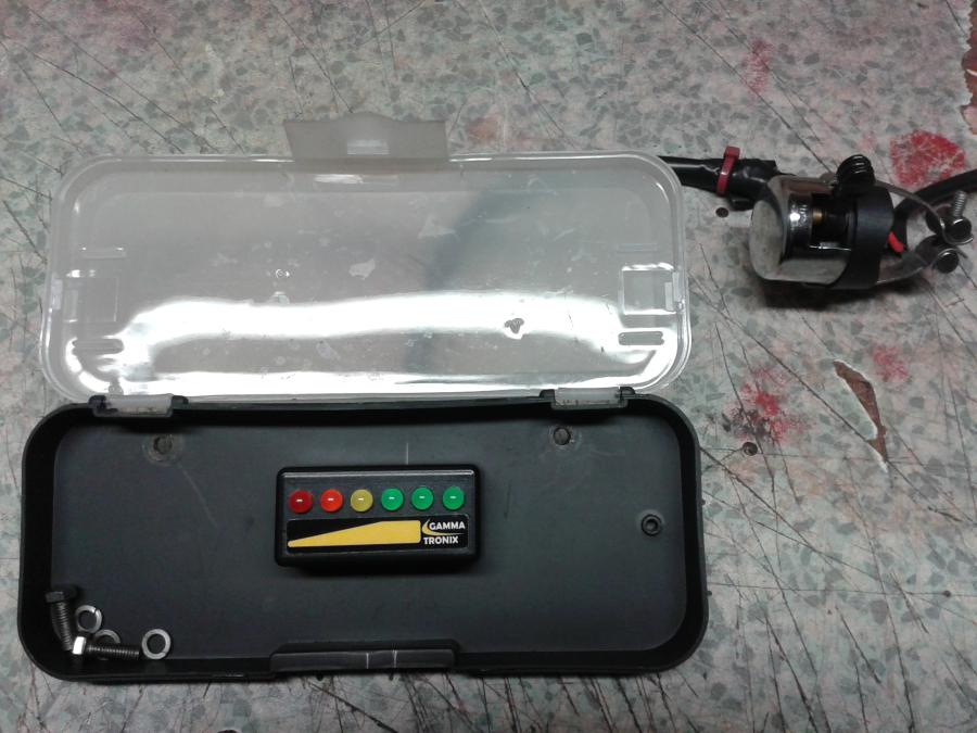

Your tale has brought some memories back. I had similar electrical woes a few back on my YX600, intermittent dying of the elkectrcal system. Got nowhere with it for weeks, so decide to install something along a similar lines to yourself., so I had real time knowledge of what was happening. Mounted on the handlebars, inside a school pencil case. It worked well too. Still got it in the man cave.
Turned out to be intermittent failure of the alternator. Had to destroy the old one to get it out, luckily got a replacement too
