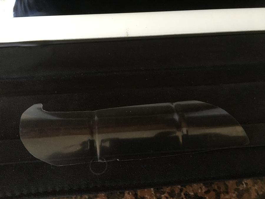

Fixed my leaking fork seals with a DIY tool I cut out from a lemonade bottle.
After a few pumps and a little ride out to see if it has fixed the problem...Success.
No more leaking seals and saved me a strip down to replace them.
