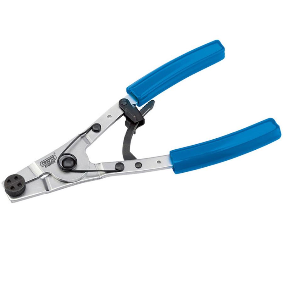

Although your foot pump method worked for the rear, you may find it a tad more difficult with the front as once you get 1 piston out you the  cant removed the rest so it makes it a tad slow and tedious doing 1 at a time ?  I'd highly recommend buying some 'piston pliers'
Paid around £12 for mine about 8 years ago and they have been invaluable for brake servicing ?
Having rebuilt my front brake last week I can tell you it takes all of 30 seconds to get all 4 pistons out of a caliper without any damage etc.
Great bit of kit
