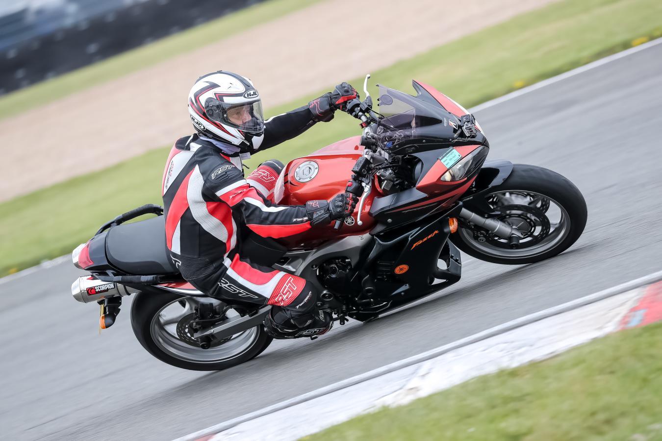

I reckon it was scraping on the concrete kerbs at the apexes. As ive gotten more confident, more bike parts have worn away. If you look at the photo, you can see where I fitted plastic sliders to the fairing because I wore a hole through the fairing. Then I wore the slider out, and felt the rear was lifting slightly at lean as the fixing point for the fairing was acting as a fulcrum, so I modded the fairing (cut the contact point away). The footpegs have long since been worn away. I made a mod to the sidestand some time ago to prevent that from dragging, it now raises up a little more for a little more ground clearance. Of course, its not really designed for this sort of stuff, and I dare say im pushing it somewhat, but I dont really fancy an out and out supersport as I cant justify another bike in the garage, so Im just trying to get the best from what Ive got really. Just an old bloke trying have some fun :lol
