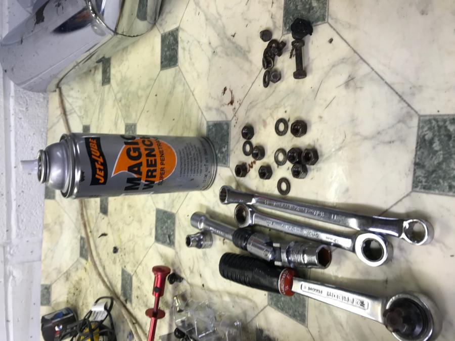

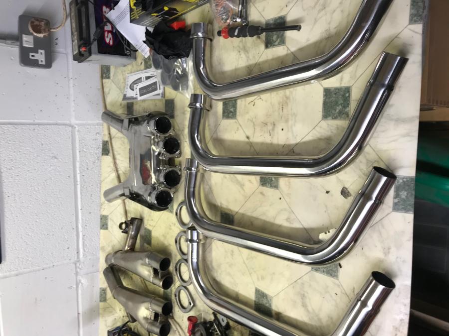

managed not to snap any studs so theres lovely. been spraying penetrant on the nuts for last week or so. new delkevic stainless system going on once ive had a good clean up of the motor. looks to be pukka quality. leaving the oe studs in and useing stainless dome heads on the re assembly. no point taking risks and giving meself a problem I aint got...
