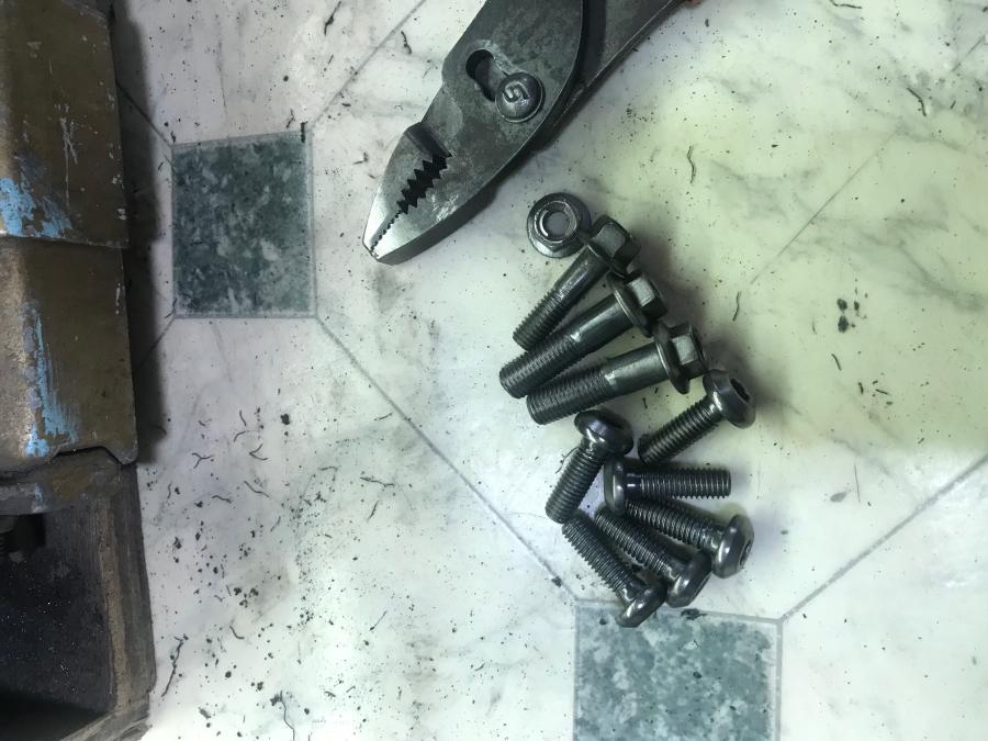

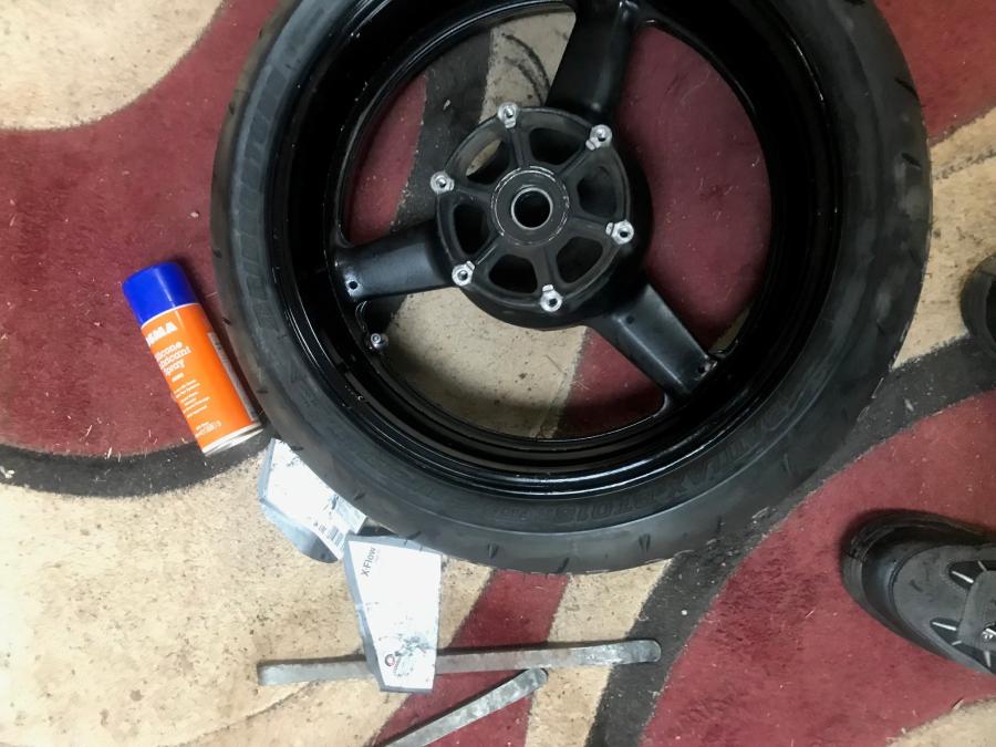

so. fitted the valve and the new tyre, then took the rear caliper off. it was pretty shitty, and the pads had 1mm left! only the second time I can remember having to change a set of rears, I guess nowadays I use the back brake as well as the frontĀ  :o :o

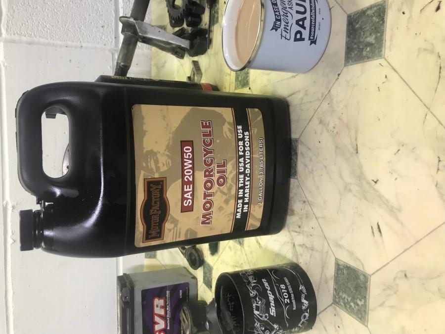

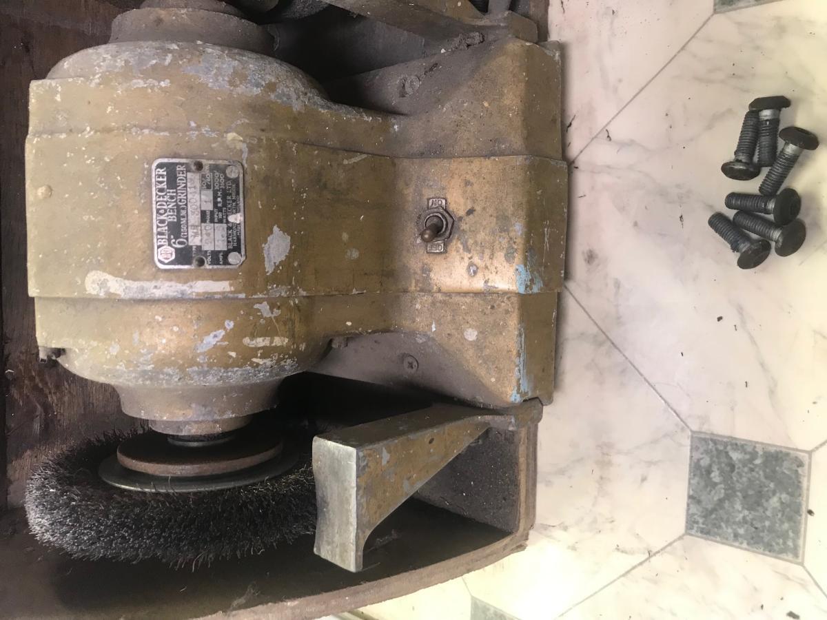

cleaned up the rusty disc rotor bolts and caliper/torque arm bolts then heat/oil blacked them to stop it happening again. Used the 20/50 mineral oil I put in the harley coz it smells nice when its burning... Wink
