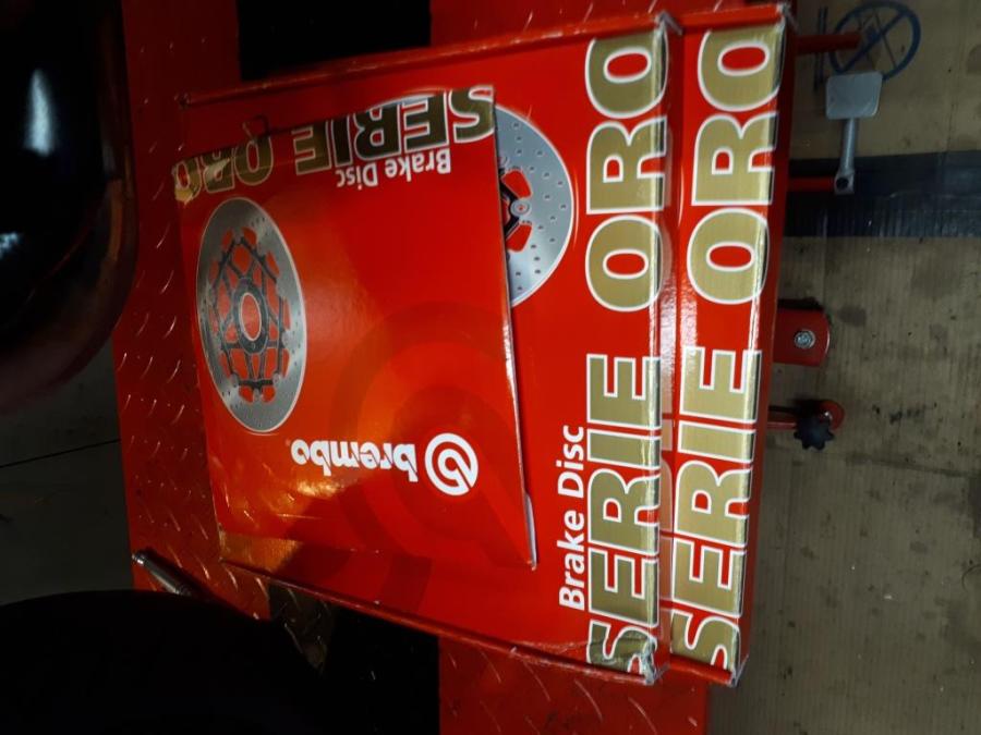

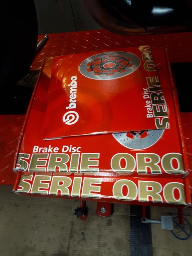

Serious make over of the 600 today and yesterday, fitted 3 new Serie Oro  Brembo discs, calipers cleaned, 3 new sets of brake pads, oil and filter changed, looking forward to a spin tomorrow  Smile
Discs were focced, rear was down to 3.6mm with fronts down to 3.3mm
My new best friend in picture 2, blow torch to soften the loctite, had discs off in minutes  Smile
