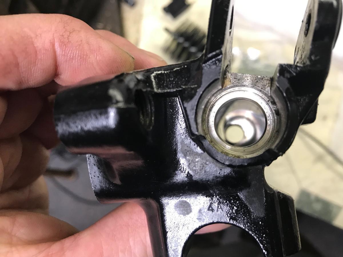

fitted a tourmax service kit to my cb1300 front brake m/cylinder.
front brake has been iffy since ive got it, fine one minute, pulling back to the bar the next.
ive fitted hel lines, rebuilt the calipers and changed the pads for ebc double h.
Master cylinder was the last thing I tried but in retrospect should have been the first, any old low miles bike thats been standing (as mine had before I got it) could probably do with a check. Fix was cheap (service kit £17, offset circlip pliars to get in there £15) and easy (with the right tool) and me yonder now has the front stoppers of a GP bike.
