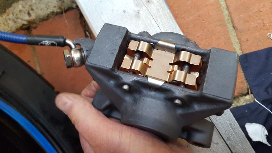

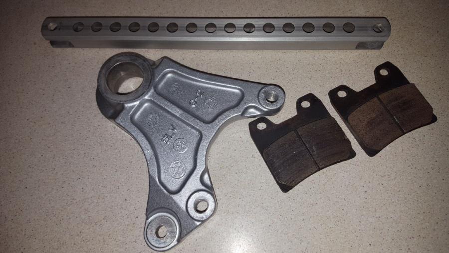

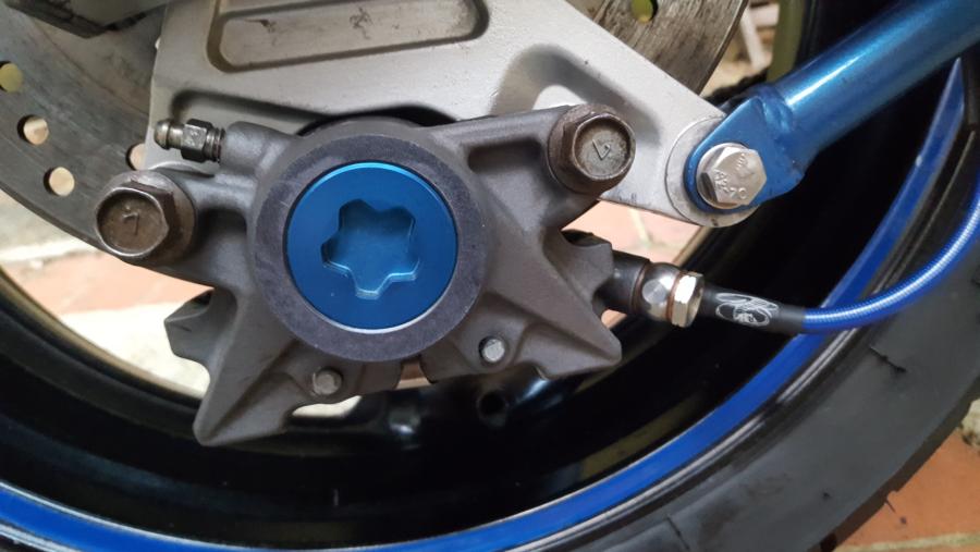

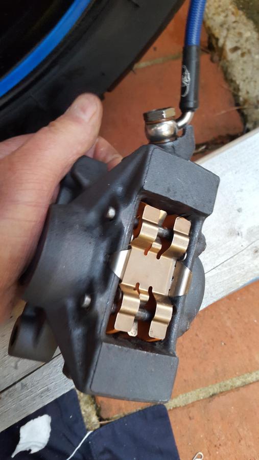

Red, I fitted a Fazer 1K Blue Spot to the rear of my 2003 FZS600 earlier in the year and serviced the front calipers at the same time, just a caution be careful the first few times you use the rear brake if you fit the Blue Sport as I locked the back wheel up by being over enthusiastic on the brake pedal. It is a great upgrade and also aesthetically it is good move to.
The pic below is the kit that I purchased from a foccer in here.
I gave it a good clean up and red rubber greased the pots before fitting and put new pads in plus new R clips
