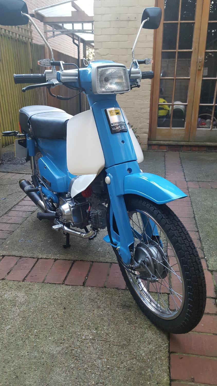

Stop teasing me Dave give me a picture of the Cub you rebuilt.

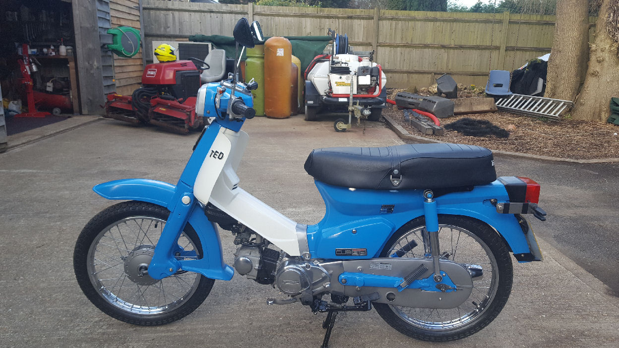

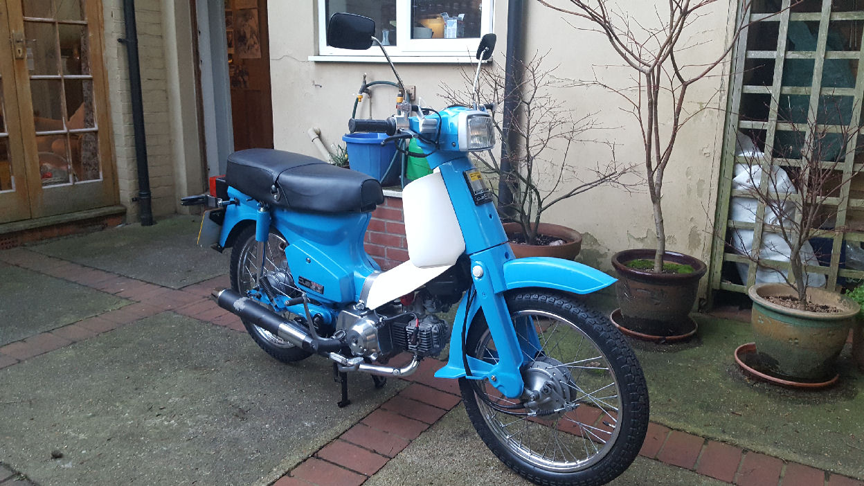

Below is a picture of the one i rebuilt over winter.
I bought it for £200 as a shed find lots of surface rust but nothing to serious the frame tube was absolutely fine as was the metal work under the the plastic bodywork/ rear mudguard, just surface rust. A friend has a sand blast cabinet so all the metal work got taken back to clean steel and all the plastic work got rubbed down and sprayed with a plastic etch primer, the metalwork was resprayed with rust inhibiter primer and 4 coat of blue top coat and two coats of clear lacquer.
Inside the body work/under fuel tank was all painted with two coat of red oxide.
New tyres, tubes, rear shocks, front leading link bushes and pins, brake shoes all round, new clutch plates, LED indicators (2 of the original were broken) battery, new bake light lens, new speedo cable, front brake cable, front sprocket and locking plate and chain, new seat plus lots of love and elbow grease, but it was worth it, such fun to ride, 54 MPH flat out but goes uphill absolutely fine, seems quite low geared, but my understanding is they were built as a city runaround, so no need for it to be any faster but its great pulling away from lights and junctions.
The whole project including buying the bike cost 760 quid, the garage that MOT'ed it for me offer me £1200 for it , when I said not for sale he said £1400, i told him he was wasting his breath as it was not for sale.
