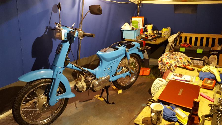

[size=1em]Just a quick update on my winter project, this are going well in the Shent or it it a Ted. (Workshop)[/size]
[size=1em]My shed is so jammed full of stuff I had to resort to putting up a large frame tent in the back garden, I am using that as a workshop for the renovation, it works surprising well as a workshop I have put down a 3/4" Plywood floor in there and constructed a bench, lots of power points, lights, WiFi extender from the house and a bloody great electric fan heater, all the comforts of home without the interruptions of normal life.[/size]
[size=1em]Anyway Honda C90 is almost back together, Had one issue with the electrics when I switched an indicator on all four came on, it was the same when I switched left or right, the problem was in the indicator warning light, I messed about for about 6 hours trying to sort that one.[/size]
[size=1em]The old adage came into play that the problem is often staring you in the face, but fail to see it, the indicator warning light is the one thing that is common to both left and right indication and there it was in the speedometer dial staring me in the face. [/size] :'( anyway it is sorted now
[size=1em]With a bit of luck should be ready to kick the old girl over tomorrow evening and hopefully she will burst into life, rather than in flames.[/size] :thumbdown
[size=1em]Fuel tank to go on with new fuel line, carb to go on (All nice and clean), exhaust, and chain and chain guard to fit, horn, and legshields. found a great big crack in the legshields when I cleaned them up I knew there was a lump broken out of them but this large crack has focced them, so for now I have cut them down, I will see how it goes and if I don't like it I can purchase a new one, but sadly my budget on the bike had been exceeded already.[/size]
[size=1em]£400 was my budget, spent £460 not including the £200 I paid for the bike, I know if I eBay-ed the bike I would easily get my money back as they are going for mega money.[/size]
[size=1em]Its been a great 6 week project stripping the old girl down to the last nut and bolt, sand blasting all the metal work, and respraying, including respraying all the plastic panels and fork shields.[/size]
[size=1em]Bit of advice for anyone completely stripping a bike down is take shed loads of photos of everything before you remove it, especially all the wiring, mark cables that go together with a permanent maker pen (Don't like to say a Sharpie, cos he gets punchy [/size] :lol I used a series of lines, crosses, stars anything that you can match up.
Anyway this is the old girl as of tonight.
Oh! got the log book all sorted out and it's registered in my name and on a a Sorn Statement for now.
