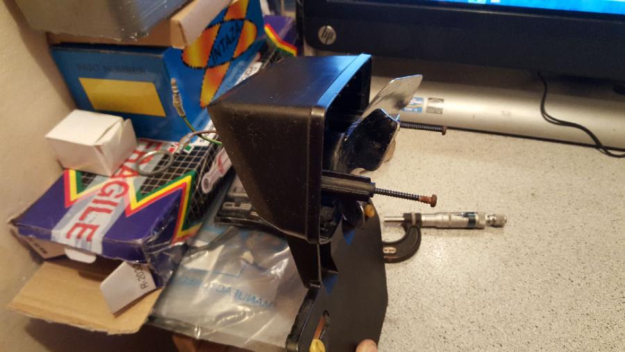

The black plastic back lamp unit was all pale grey with fade so did the same to that and that has come up well to, only problem is that it is so charged with static that it is a dust magnet now  :lol
