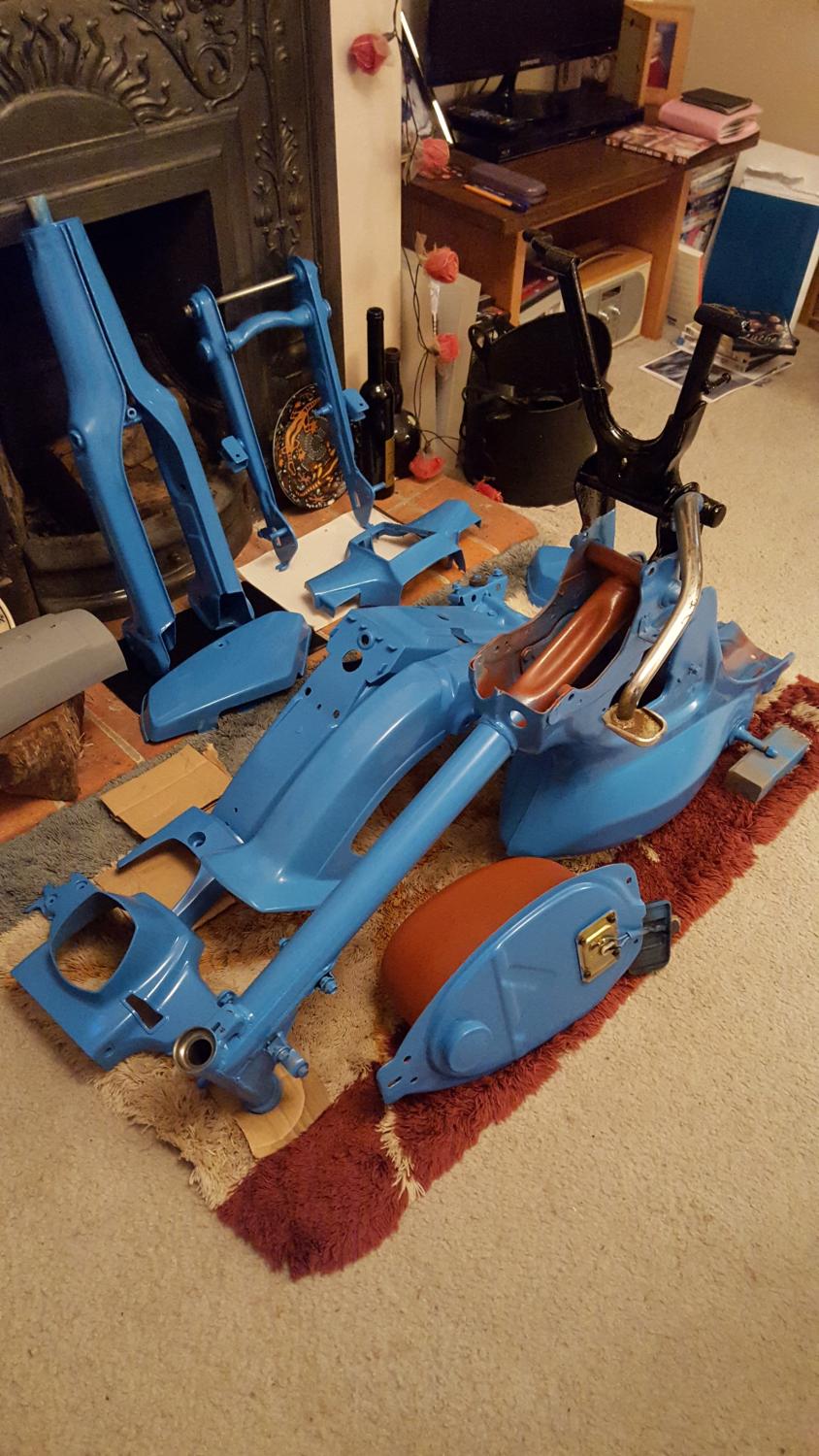

Well some time had passed since I posted in here.
Quick update on the 1989 Honda C90-G.
Completely stripped the Cub down and was pleasantly surprised at how little rust was on the old thing, the bits that had surface rust I sand blasted in a mates sandblasting cabinet and removed all trace then spent hours with wet and dry rubbing the thing down.the insides of all the box sections have be painted with Red Oxide, the body work including all the plastics have been primed/undercoated and given four coats of china blue enamel just a couple of bit left to spray, I have run out of china blue paint so order another can.
Huge clean up in the shed everything was covered with blue over-spray dust.
Popped the cover off the side of the engine to reveal knackered clutch plates, I had anticipated that one and had a full gasket set and new plates sat on the bench, new clutch in this afternoon and had to spend about an hour and a bit cleaning the old gasket off the two halves of the case, not sure what those Japanese fitters use but it was a bastid to remove.
Anyway new clutch now fitted.
New tyres and tubes and rim tapes arrive 3 days ago so will fit them tomorrow (And mend a puncture in my push bike at the same time)
Finish off a bit more spray painting when the paint arrives then leave it for a couple of weeks for the paint to really cure before starting reassembling the old thing, actually I might leave it until the end of the first week in march before reassembling as I going be out of the country for a while.
Nothing particularly exciting just visiting relatives and going with the wife to a book festival in Dubai.
