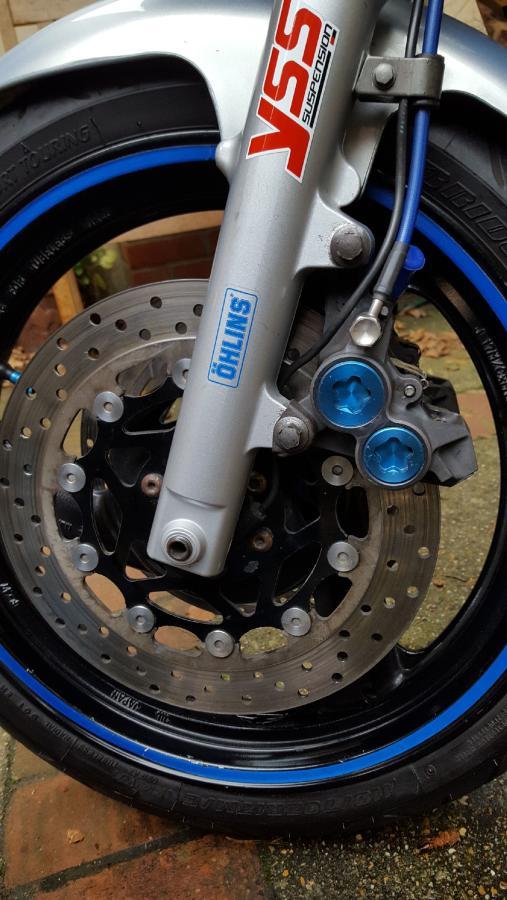

Since fitting the blue spot rear caliper I decided to completely service the front two blue spots.
Spent the afternoon out on the patio in fairly pleasant weather hint of sunshine for a while.

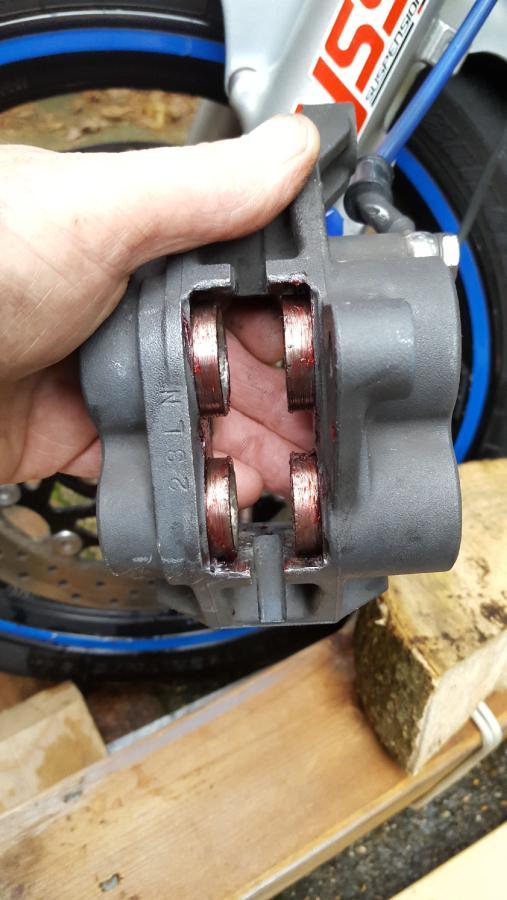

Removed calipers (Left the brake lines connected) gave them a good soaking in hot soapy water hanging in a bucket and used the wife's toothbrush to give them a really good scrub, gently pushed the pistons out a little so i could really clean them (Thankfully no rust what-so-ever) rinsed and dried and red rubber greased the piston, remover the top of the Master Cylinder and gently pushed the piston back into place , removed excess RR grease.

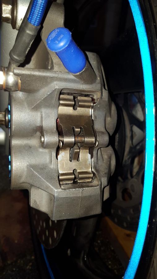

Pads still have lots of life in them so cleaned them and lubed he rear of pads with a smear of Copper Slip along with the pad retaining pin and R Clips.
Spent about 3 hours doing the job but well pleased with the outcome, looks better as well with nice clean calipers.
[size=1.35em]Tip[/size]: The spring that bears down on the pads by the brake pad retaining pin has to go on the right way round, the spring is not symmetrical, seen on one of the pictures below.
