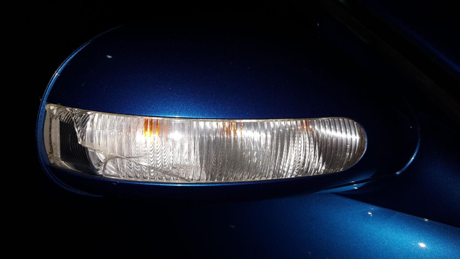

[size=1em]Got home and looked again under the light of a very bright military LED torch and low and behold, [/size]
[size=1em]See 1st picture drivers side mirror indicator repeater £59.99 thank you very much.[/size]
[size=1em]2nd picture how she looked before the broken indicator[/size]

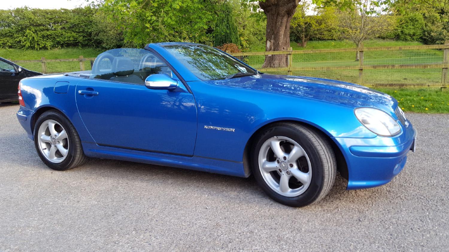

[size=1em]3rd Picture made me smile again.[/size]
