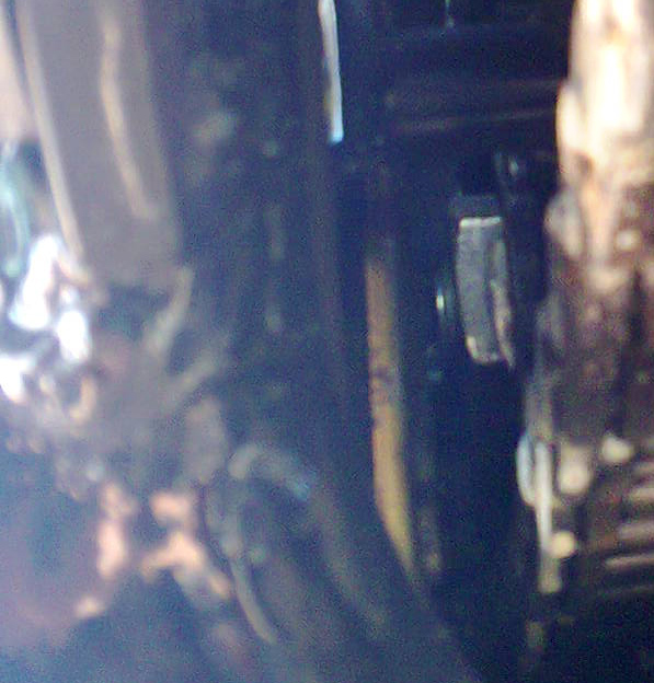

(17-07-17, 09:59 PM)tommyardin link Wrote: One 10 mm bolt on gear change and a few allen screws its worth just checking the sprocket nut if the chain set was making a lot of noise, just as a precaution, 20 minutes off and on again, as against engine strip down and a shed full of expense if its gone tits up down there
If its clean enough in there you can actually see the nut if you lay on your back with a torch - or at least you can see if its on- like this
Attached Files Image(s)
