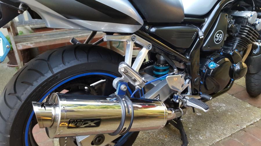

The right hand side top of my swing arm has has some marks/scuffs on it from the time i purchased that old girl (Fours years ago) so time to do something about it.

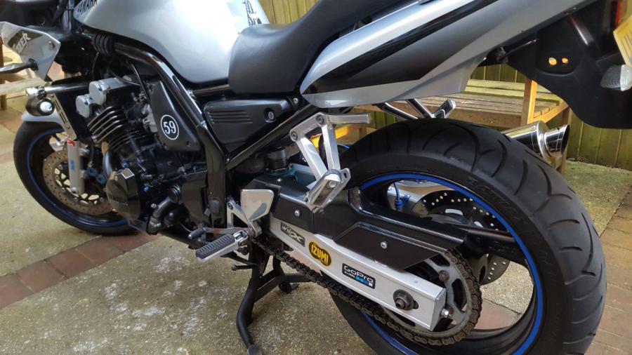

While I'm in that area off with the carbon look rear hugger (Power Bronze) and cut it down to make a carbon chain guard (Really pleased with it) and spray the top of the swing arm after striping off the rear peg hangers and rear master cylinder, then masking up and sanding down before spraying two coats etching primer, 2 coats grey undercoat, two coats of silver and two coats of clear lacquer.

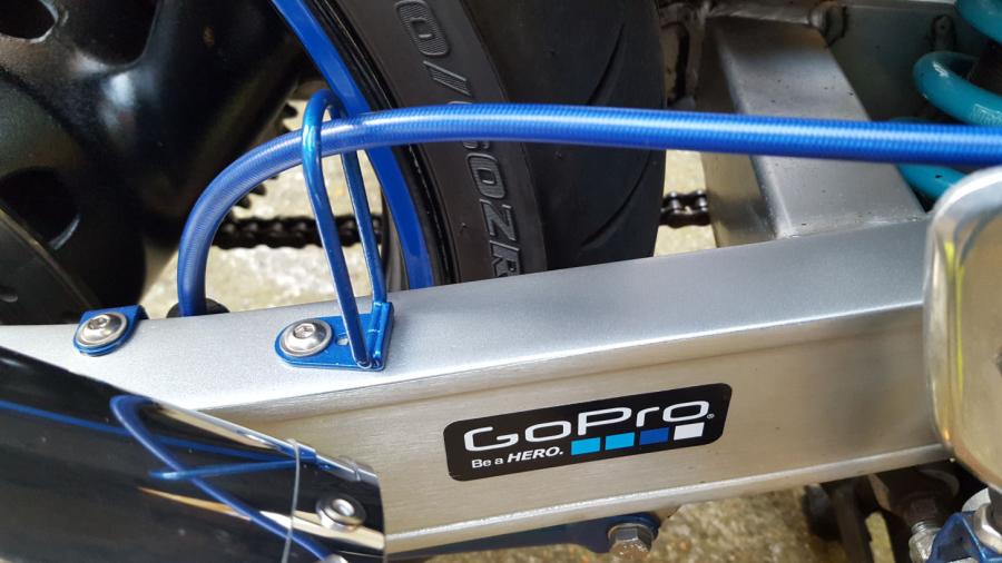

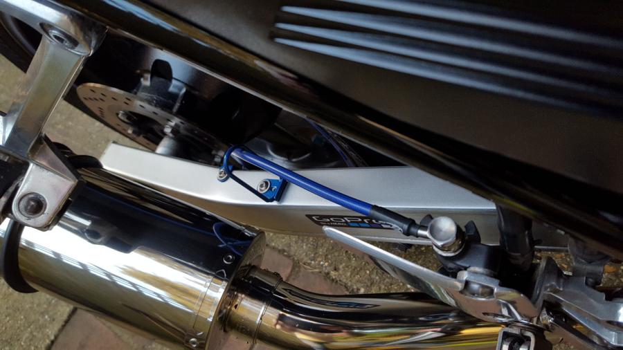

Again I am really chuffed with the finished job looks good, the paint I used is a really good match for the swingarm. I also gave the rear brake line loop and anchor point a touch of the blues.
Halfords paint is very good I am impressed with it, sprays nice and clean without spits and splatters and covers very well.
