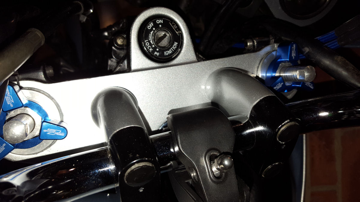

Top Yoke was looking a bit tatty where keys have scuffed an arc into the paint finish, so removed yoke and sanded it down a good coat of etching primmer, two under coats, 3 colour base coats and two good clear lacquer coats. It was black but now it metallic silver, I painted the handle bar posts at the same time but kept the clamps black.
Also removed other two keys from the ignition key so should not happen again. Confusedun
