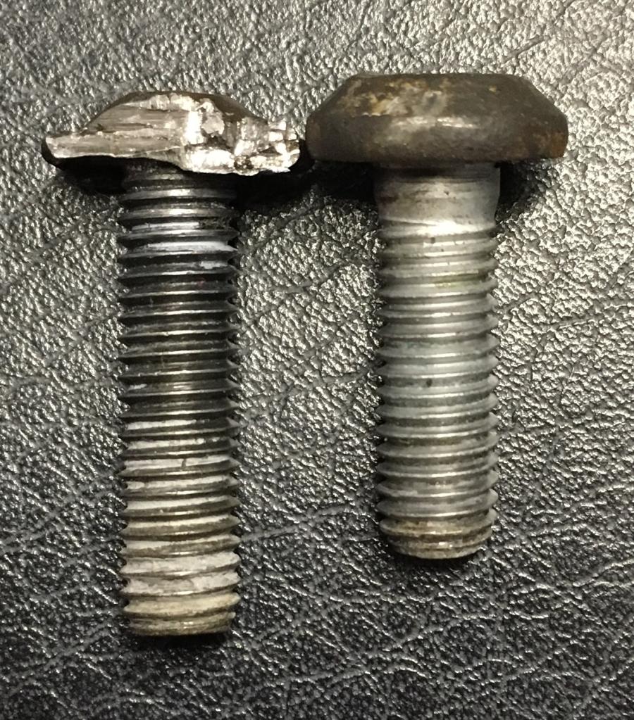

I've never seen anything like that before!  :eek
I had a look at the two bolts when I took them out and they're not standard ones, so the last dickhead whoc changed the disc must've ran out of bolts an dused whatever was lying around.
They're 5mm longer, which meant they protruded out the other side of the wheel and corroded to shit, making getting them through the thread a real pain.
