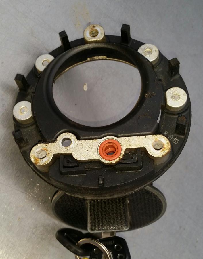

For anyone who doesn't know, the lower hole is the cap breather that goes straight through and gets covered by the orange rubber cap.
And the hole to the left is the drainage hole for excess fuel, or any water that may leak through.
The rubber gasket was in very good nick so i just cleaned it up and swapped it over.
