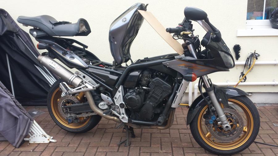

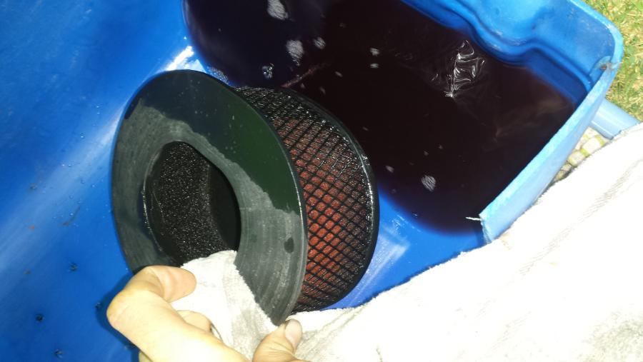

replaced the clutch cable "all by myself" Big Grin  ten minute job,,as one thing leads to another decided to take out the air filter as it hadnt been cleaned or checked since it went in back in scotland while getting ivanized ,must be 2 if not 3 years back  :eek  i know im a tit ,it was black with the dirt even had a bit of rag in it ,dont ask me how that ended up in there :rolleyes  steeped it in kerosean and used k+n cleaner stuff i got from UNFAZED to to rinse off the kerosean ,put it in front of the hairdryer for an hour and by tommorro it should be fully dry.should be running a little cleaner then Big Grin
