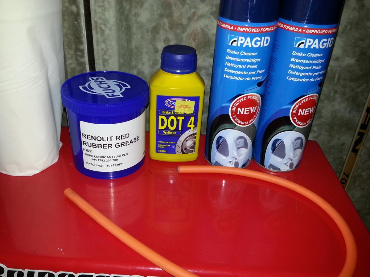

Stripped and cleaned the front brakes, found 2 pistons in each caliper were not moving and each outer brake pad was down to 0.040 thickness!
Left them in bits while I get some new brake pads, the ones that were in I think are oem, say sumimoto on them and are GG rated, any recomendations welcome, looking at EBC grade HH .
