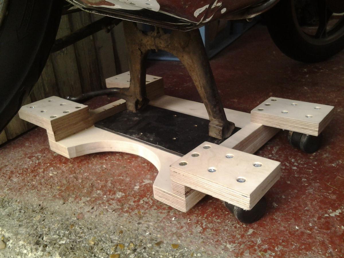

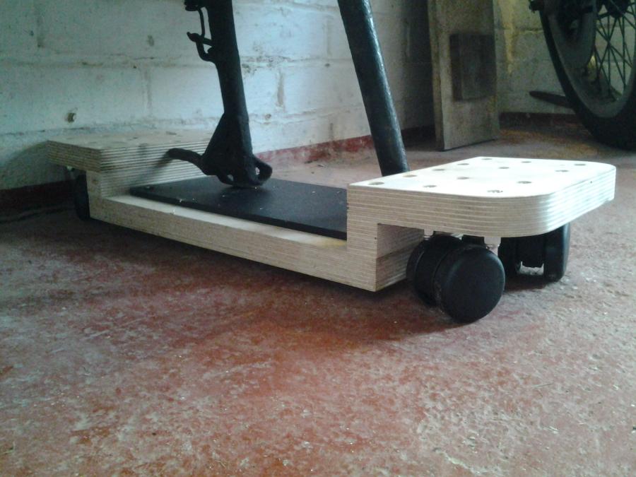

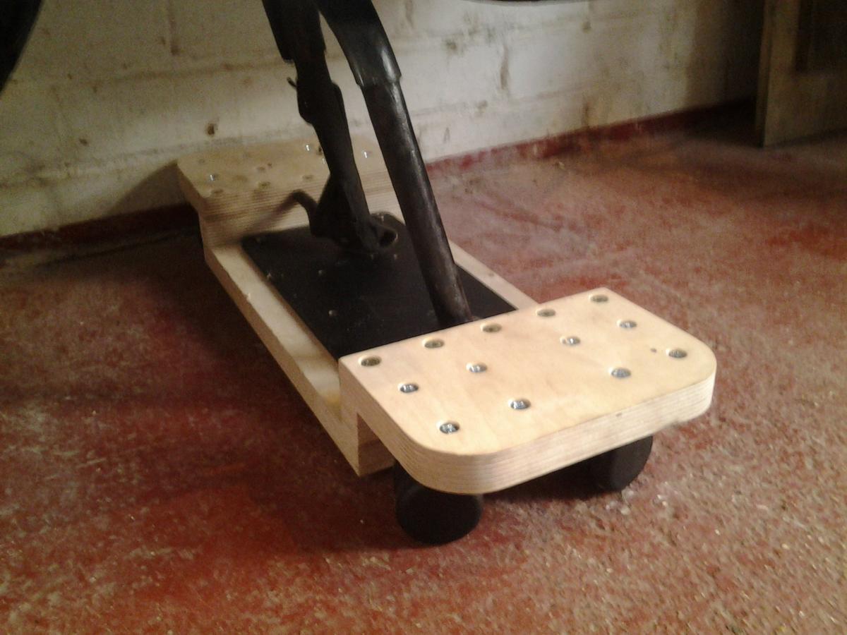

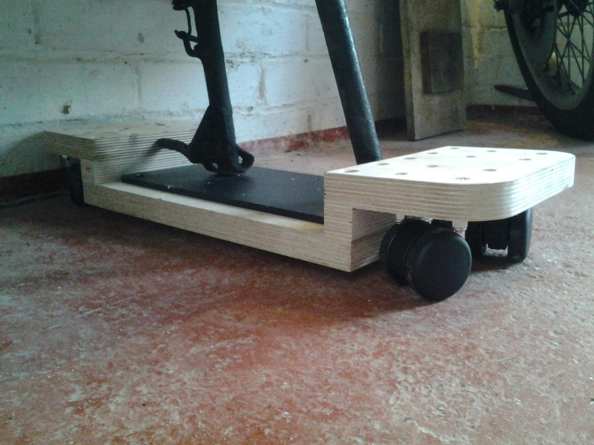

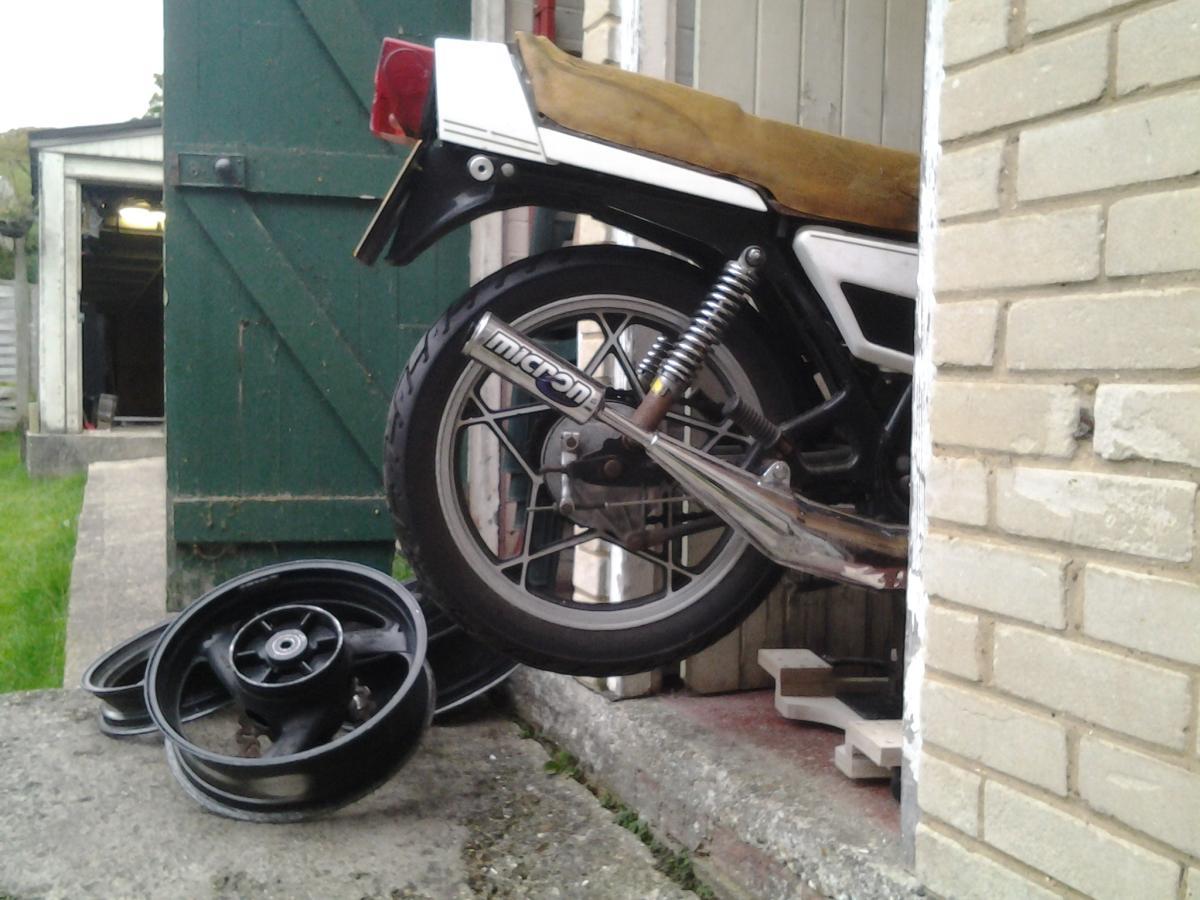

Made a couple of bike skate boards for my jap classic 250's, snug fit in the shed, can now push the bikes in, put them on the boards and push them sideways against the wall, bikes are higher off the ground so if I push the bikes back over the step to the shed it makes rear wheel removal easy...
