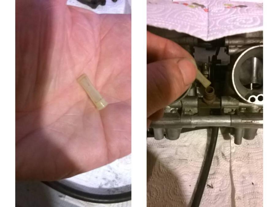

There is another inline filter where the petrol hose pipe fits on the centre carbs T piece. Be carefull removing it as the fitting between the carbs is plastic and you don't want to break it. See pic. This filter is usually forgotten, it just needs to be cleaned if it is dirty.
