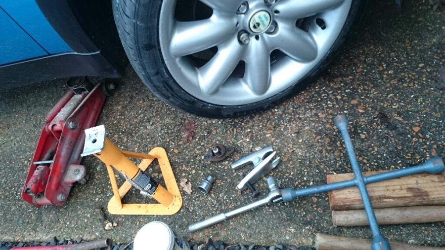

Went out on the fazer to machine mart to get a ball joint splitter.  Not been out for a while and felt good.  Took out the delkavic exhaust baffle for extra fun.  Got the splitter home only for it to snap in half when releasing the lower ball joint on me mini. I think I over stressed it.  So back out on fazer for another one.  This time I tensioned the splitter on the joint, then applied blow torch flame on the lower suspension arm to release the joint. Made quite a  BANG when it gave way.
Out n about on fazer, played with spanners and car passed MOT in the end. Enjoyable day really Tongue
