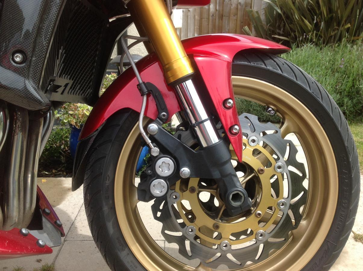

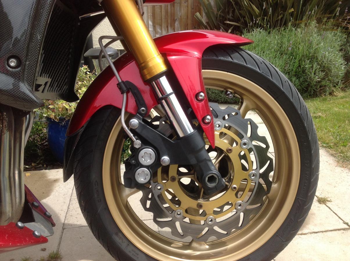

Then i got a cable tie on the front fork.....35mm static sag with me on it.....excellent :thumbup [size=78%]........then after a spirited ride it is as follows.......i think that looks good doesn't it.....i've got quite a bit left before it bottoms out which is good as a margin for safety....i did hit some pretty harsh bumps and went over fast crests.[/size]
