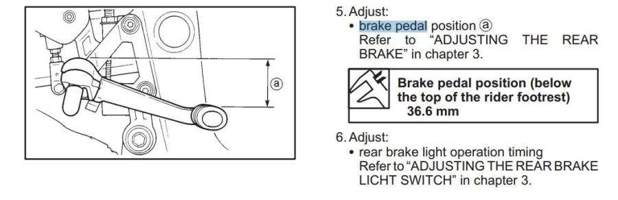

HELP!!!!! Rear brake issues
First check is if this adjustment measurement correct. See picture
If that measurement is ok, checck the brake hose for damage and then bleed the brake with the pistons pushed fully home.
