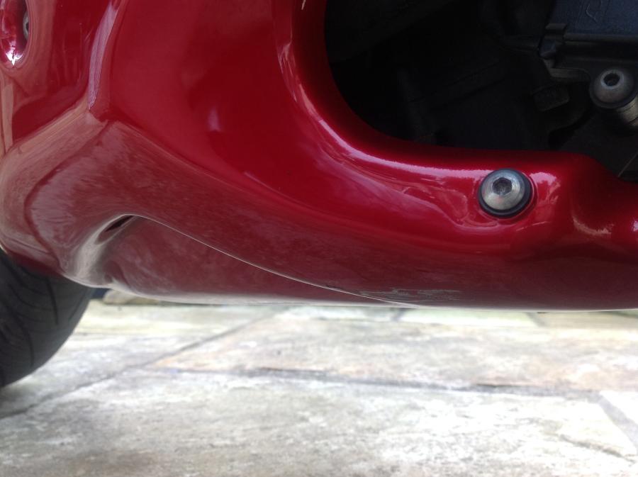

Next on the agenda is raising my yokes back up as i clearly need more clearance......i just noticed i've slightly scuffed the left side of my belly pan like the right and i don't even like left handers......& before you start slimwilly no I'm not bullshitting and i aint no Rossi :b [size=78%] but it is what it is.....most likely less clearance....heavy lump rider and incorrect suspension set up.[/size]
