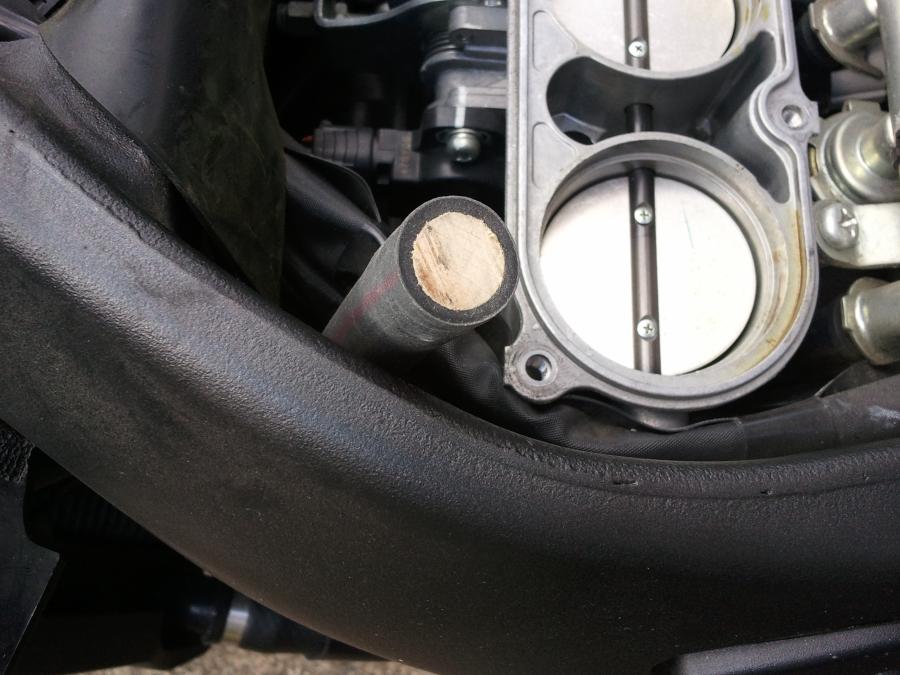

After finding the 2nd hand power commander a workmate had was for a completely different bike and I could not fit it to my FZ1, I decided to block off the ais because I found the exhaust popping was becoming annoying and blocking off the ais is meant to reduce/stop it.
So I capped the pipe that goes to the air box first.

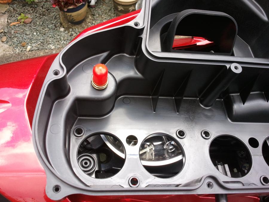

Then I found a little red cap to block the air box hole off with. ( Matches the colour scheme of the bike as it is red and black) Smile .

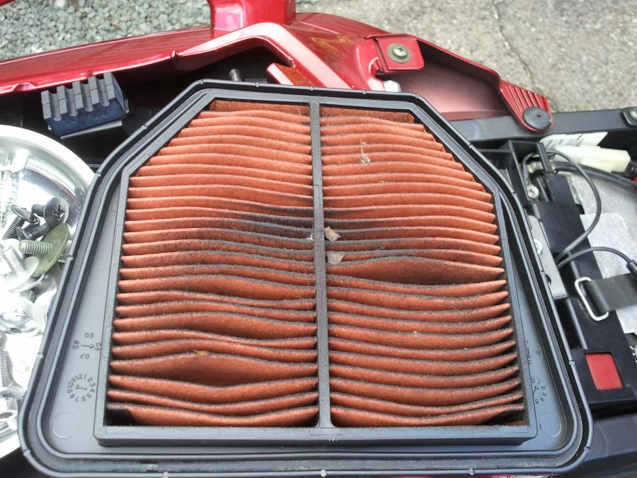

Then I ordered a new air filter as the state of the one in the bike was pretty bad. :\
