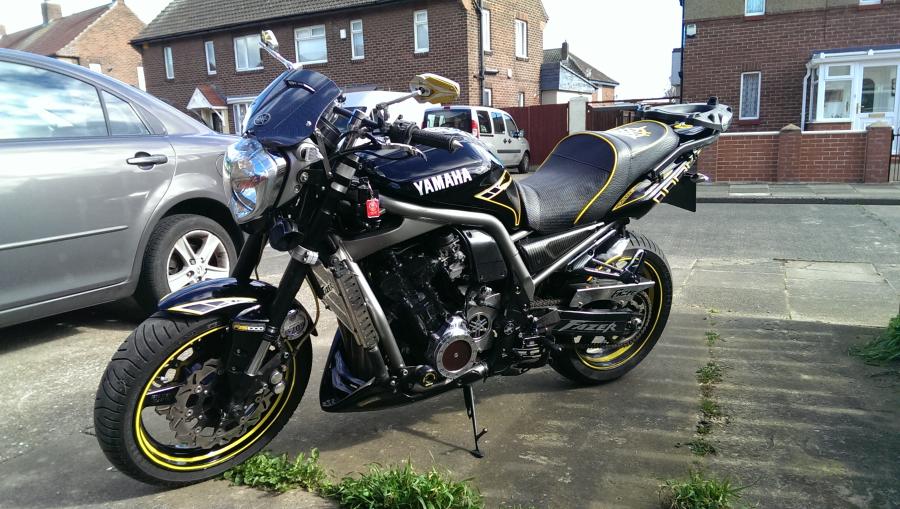

be careful of all those cheap bikini fairings none will pass mot as no beam pattern, best off with an old lc350 headlight or any 7" round or mt03 fz6 depending on money available...mine has fz6
