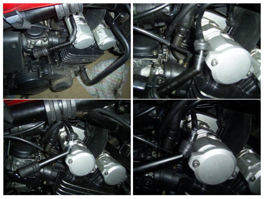

Pushed back the rubber boots on the Coil end of the Plug caps and coated the area with Vaseline.
That will stop the water getting in and causing the rough running. Smile

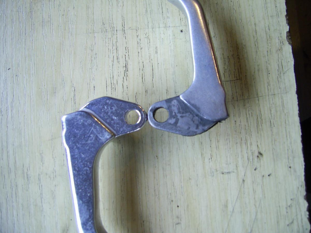

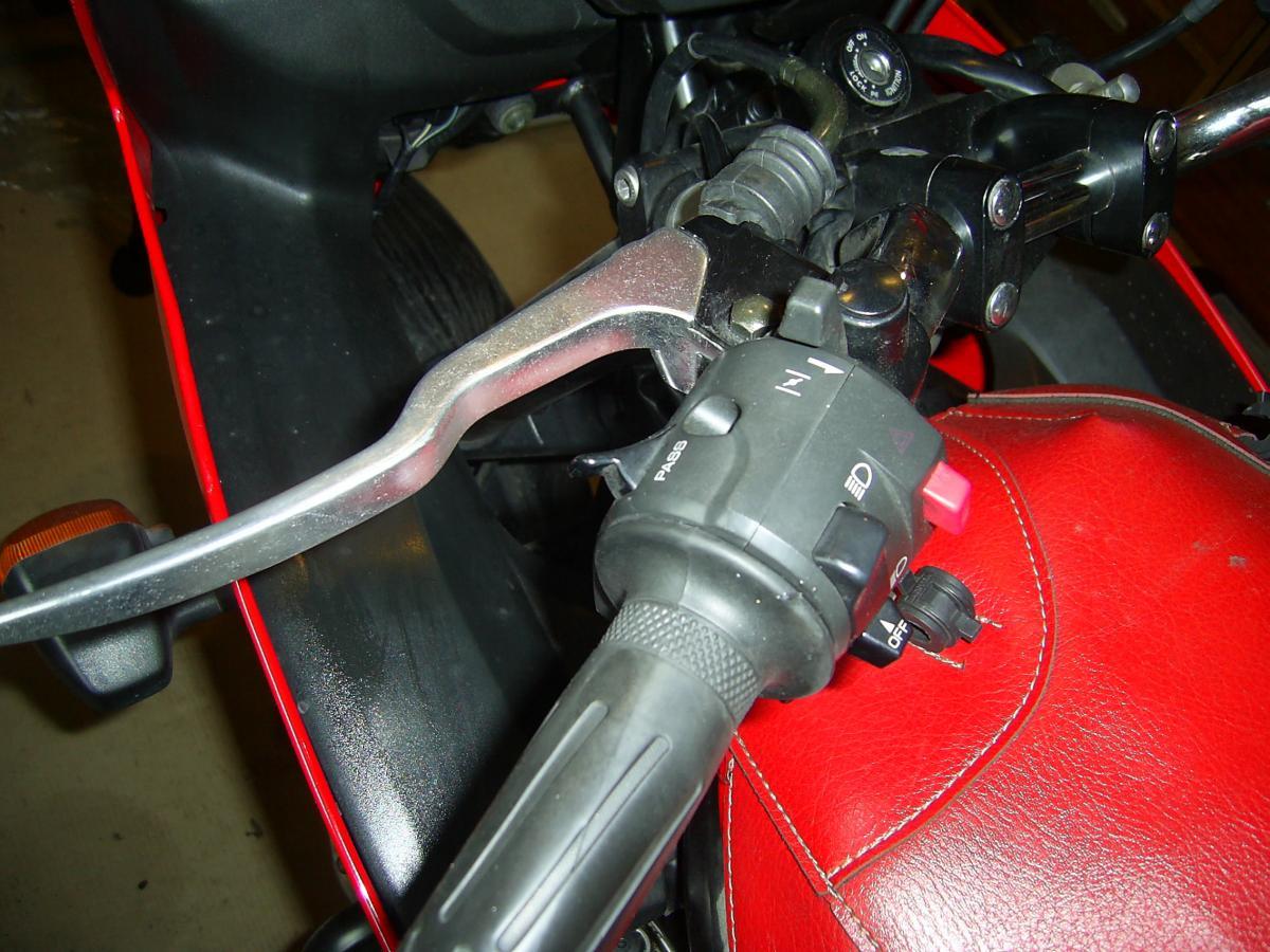

Replaced my worn clutch lever, clutch back to normal feel again. Big Grin
Difficult to see the hole wear in the picture, but the difference is always amazing
