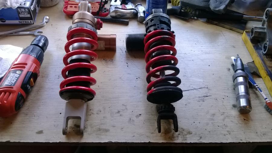

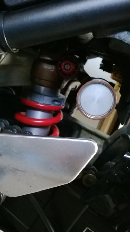

Took the Thou for a spin after finishing changing the original rear shock for a 2012/13 model s1000rr rear shock. What difference, no more wallowing through the high speed bends.  Smile
It raised the rear by 10mm and with the forks up through the yolks by 10mm. Turns in nice and quick, more like the 600 Smile
