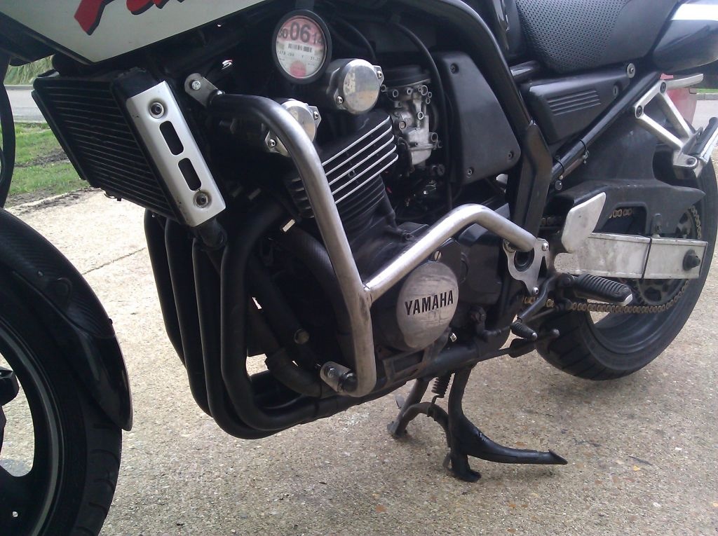

Think i've sussed out what's goin on now...apage supplied me with bolts plus some spacers, now i wasn't entirely sure where the spacers went, there was a small one & a big one......i should have asked him as he did say to message if i had any trouble...so on closer inspection of his previous photo i can see that woola in the pic his rad hose doesn't have to go round the bar....because the bar isnt flat against the mounting point....look closely at the pic...the flat foot of the bar isn't flat against the frame...it is out by an inch as if not properly driven home yet....so the spacer goes in that space then..maybe...but that means the foot sits out from the frame & im not sure that defeats the purpose of having a foot in the first place???...so i need to find someone with standard rentec full bars to compare against.think mick might have some.
To be honest though i'm quite focced off with the whole thing so i might sell them anyway...they'll need some light sanding & a lick of black paint though.
Edit.....ok i messaged Mickvp & he very kindly checked his out...& indeed there is a spacer on the left side...& so the bar foot sits off the frame by an inch in order to avoid the hose.....who woulda thought it!!!....perhaps an afterthought by Rentec maybe i dunno but certainly not how i imagined they'd fit, instead of that foot taking the impact pressure it is in fact all on the bolt.
