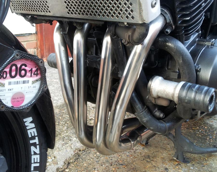

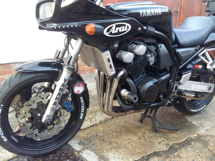

So, this was the result of using Optiglanze!
I just sprayed it in small amounts on a little piece of Scotchbrite pad and started scrubbing.
I probably scrubbed each pipe for 5 minutes before rinsing off then moving on to the next one.
It removed some of the rust but not all of it but i wasn't expecting miracles, as it's the result of long crappy winters with salty roads.
And i couldn't get right to the top of the middle pipes as i was scared of messing up the new paint job, but that's no problem, they're pretty much hidden away.
You don't need to use a lot either as it foams up like washing up liquid, so even though the bottle is only 250ml i reckon you'll easily get 10 goes out of it.
After a full rinse i gave it a quick wipe over with the Meguiars polish and......shiny silver pipes again Big Grin
I'll be gutted when it rains next though :'(
