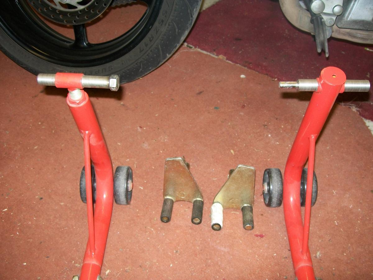

A friend has made me these for when I cleaning my bike, they replace the ones with fingers which can slip if you're not careful, ok you can't remove the wheel but ideal when cleaning etc. one has a 19mm nut drilled and welded on the other is turned down to 3/8 in or 9.5mm approx.
they also fit my MT-01 which was a struggle on the other type.
thanks to Paul for making them........ patt pending
