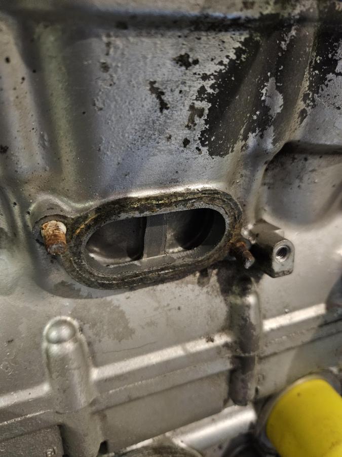

So, progress (sort of). I didn't like the look of the corroded aluminium casing on the front of the crankcase. Went to take it off and both attaching bolts snapped and the casing broke.
I've learnt how to tig weld aluminium this afternoon  :eek .
I have removed the upper remains of the bolt - that one was easy. The other is proving a bit of a C***. I've tried heat, no joy, so I've ground it down and will drill out and retap/helicoil as required.

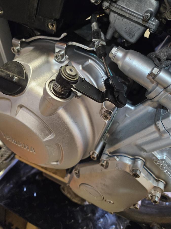

But, by far, the best thing I've done this weekend is fitted the longer clutch operating arm. I fitted a new cable at the same time - made all of the adjustments (for a change) and I wish I had done this years ago - possibly a one finger clutch operation.  Big Grin Big Grin Big Grin

Well, you’ve certainly been a busy boy. I presume you drilled the stud out ok, as I was going to suggest a gadget that I’ve got. It looks like a drill chuck with flats on the outside, and gets screwed on anti clockwise. As it’s tightened with a spanner the internal jaws grip the stud and unscrew it, usually with a high success rate.
I remember you getting an alternative clutch arm, what bike was that initially for. Good going with the tig welding. Went to night school years ago for general welding techniques. A guy there just wanted to hone his tig skills as was building a plane. Great pics, by the way :thumbup
Just read back through your carpal tunnel post, so the clutch arm is for an MT07. Did it go straight on using the original cable? Is this the correct part number 1WS 16340-00 ?
Did it go straight on using the original cable? Yes
Is this the correct part number 1WS 16340-00 ? Yes
Straight swap - I fitted a new Slinky Clutch cable at the same time. I'll find out how it goes when I've completed the rest of the job.
I managed to get one of the snapped bolts out using a tool like you described - a stud puller, but the other stud has very little room for that tool. I have cut it flush with the crankcase and I'll get the drills out at the weekend (if I'm not working). I don't like using extractors of the easy out variety, never had much success with them, so I'll probably start drilling small and build up to M5. If needed, I'll helicoil it to be sure.
I forgot to take pictures of the welded casing - and I've now covered the area with JB Weld, which needs filing down to look pretty.
Thanks for your replies, very helpful. You don’t think the left handed drill and extractor method is worth a try then, as that was my only other suggestion, other than welding a nut on it, which you can’t do now. Still, I suppose you’ve had to get round similar situations on aero engines plenty of times. Getting comfortable with decent access is half the battle as you no doubt know only too well.
I changed my clutch cable a couple of years ago, purely as a precaution, but opted for a very expensive oe item. I’ll certainly consider the clutch arm mod, as having broken a knuckle on my left hand 2 months ago, it’s far from pain free. Going for a whizz on Friday as the forecast is good, to see if it’s going to be much of a problem or not.
