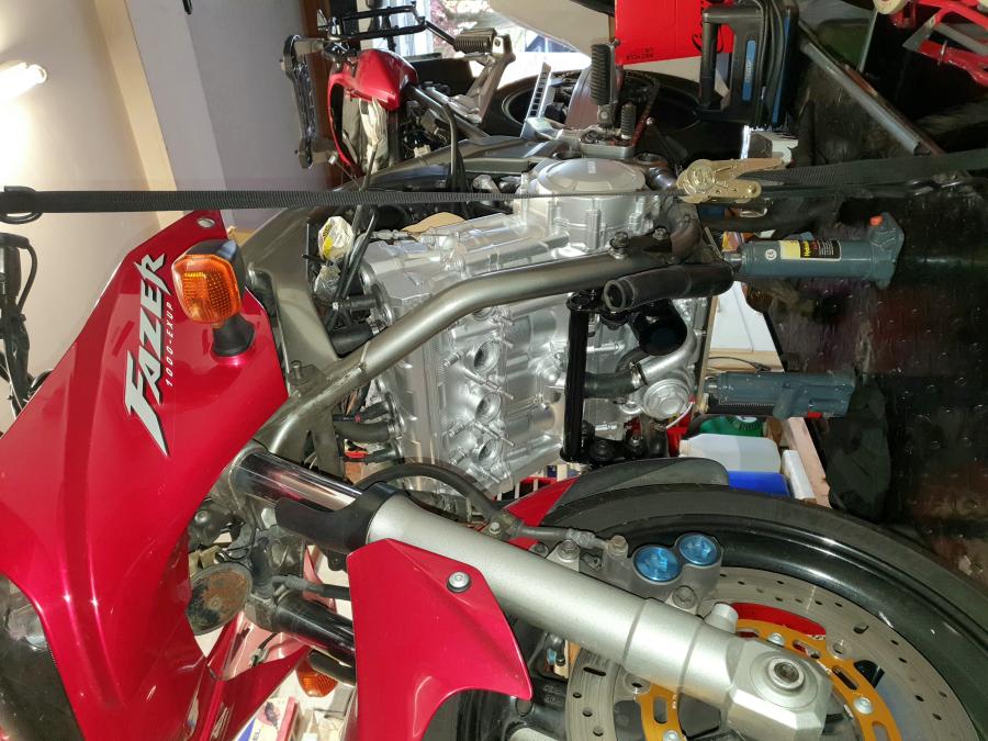

Robbo - here's more progress.
I hope you've had a good weekend in the home of cheese eating, surrender monkeys........ :lol
Excellent job you're doing there :thumbup . Currently at a heaving Eurotunnel terminal, full of screaming kids....if only they had on OFF switch :lol

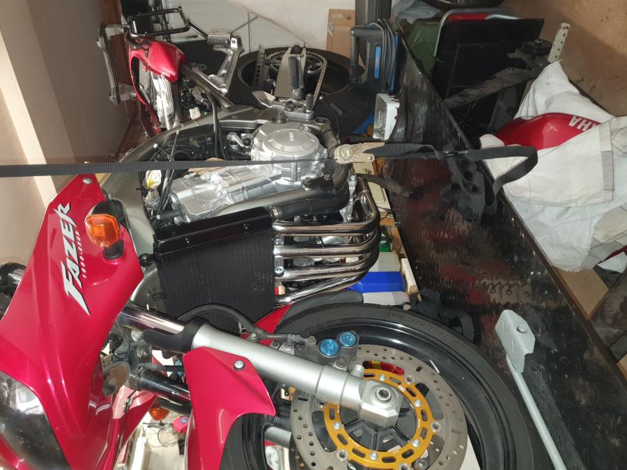

Yesterdays progress......
Very nice job indeed, especially with the engine in place :thumbup . Certainly gives inspiration to anyone with the common silver engine flaking problem. It'll be too good to ride soon :lol .

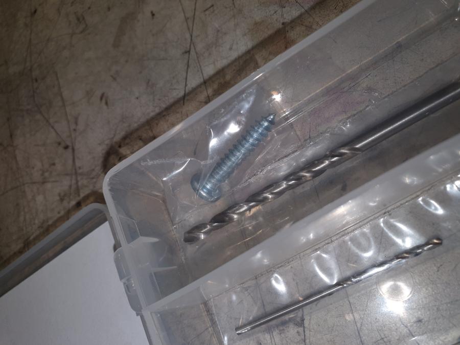

Just checked the kit - WTF is the self tapper for?
[/quote]For blocking off a hose ?
Mmmm - possible, I hadn't thought of that  :eek .
I know what it for............
[/quote]And……..
Some yank carbs have a blanking cap over the air screws, the self tapper is for pulling the cap out, you probably won't need it for a UK bike.

(28-04-22, 08:30 AM)Captain Haddock link Wrote: Some yank carbs have a blanking cap over the air screws, the self tapper is for pulling the cap out, you probably won't need it for a UK bike.
haha lol - exactly that.
