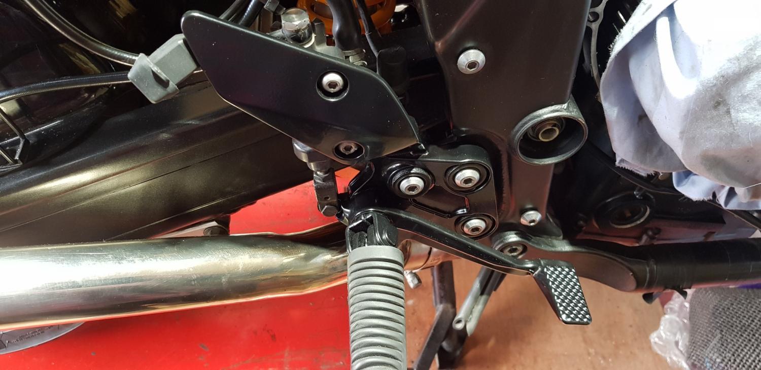

Very inventive, well done :thumbup . Collected my powder coating up today. They made a good job of the pegs, hangers and gearlever, brake lever. Got them back together and on the bike this afternoon. However the clutch cover didn't get done as they were unable to match the colour well enough. Will try an alternative firm tomorrow. Anyone in the Sussex/Surrey area that needs any bike related powder coating, bear Kirdford Shot Blasting in mind.

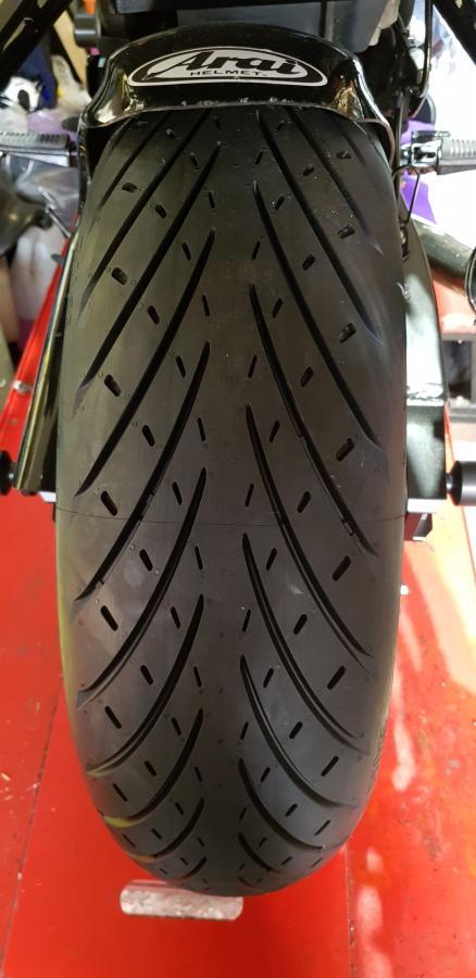

Had a visit from the mobile tyre fitting guy, so with a new rear Metzeler fitted, I should hopefully be set for another year of fun and frolics. Still waiting for the clutch cover to come back from powder coat, so haven't been able to progress much since installing the black finished footpegs, other than a general brake clean and rubber grease. Can't say I'm looking forward to pressing in the new clutch rod bearing though.
