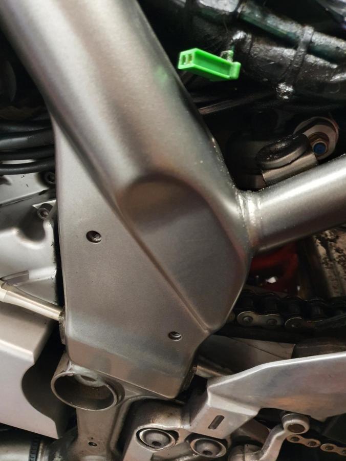

Touched up the frame rails on each side.
Nice job :thumbup
