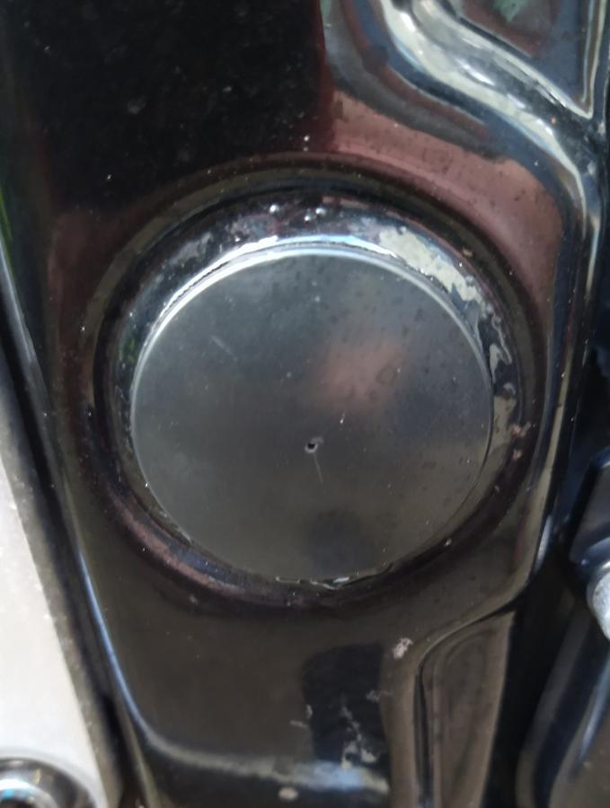

I replaced the plug that covers the swinging arm nut.
I used the plug in the photo from ebay. I had to cut around 9mm off the depth and around 1.3mm off the diameter of the two remaining flanges.
Tapped in a treat and I think it looks pretty good,  especially for only 55 pence (£2.20 for four.

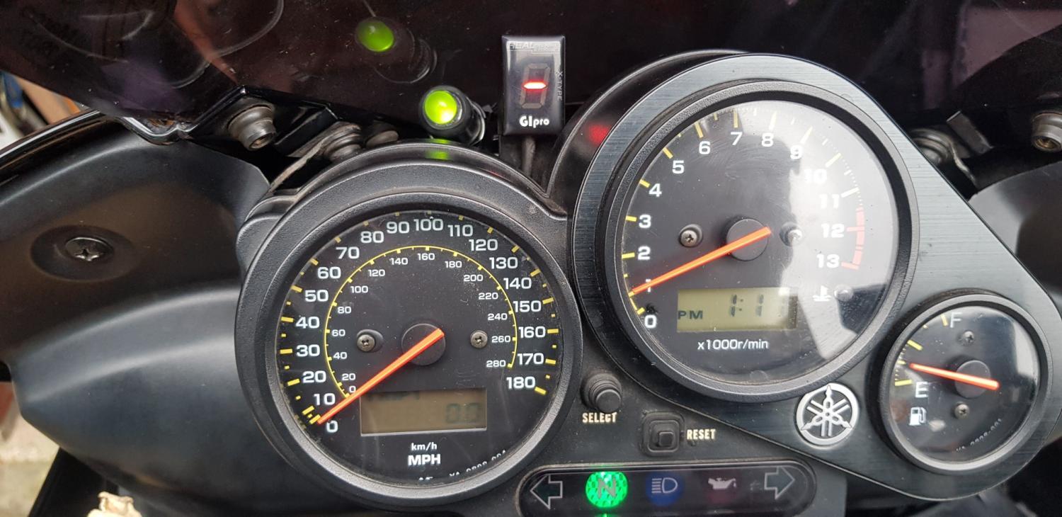

Fitted a Gammatronix battery voltage monitor. Next time the reg/rec gives up the ghost, at least I’ll know about it before I’m left stranded.
(29-10-20, 09:16 PM)robbo link Wrote: Fitted a Gammatronix battery voltage monitor. Next time the reg/rec gives up the ghost, at least I’ll know about it before I’m left stranded.
:useless
(29-10-20, 09:28 PM)fazersharp link Wrote: [quote author=robbo link=topic=6412.msg320958#msg320958 date=1604002588]
:useless
[/quote]Have a look at the Fazer 1000 section, headed “A couple of electrics questions”. That gives the info on the reg/rec I used. The monitor is literally a large LED. I’ll post a pic tomorrow, but won’t be very exciting. :lol
Ok no need for a picture - just been to the 1000 page. How does the led work and tell you what is happening

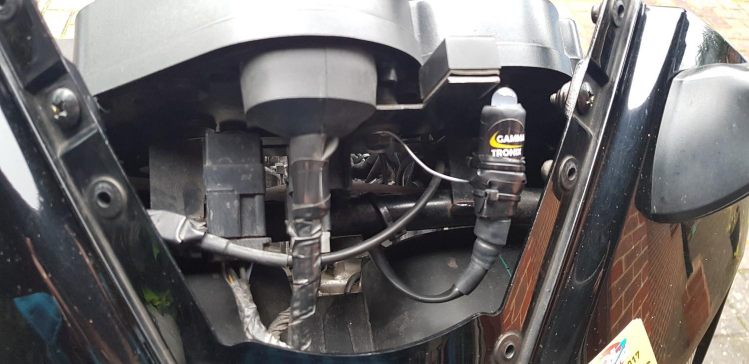

This company, Gammatronix, make several types of battery monitors for various situations. The one I went for is fully waterproofed, and is designed to be velcroed/zip tied, pretty much anywhere. I fitted mine alongside my gear indicator which utilises a bolt at the back of the facia. The 3 wire harness is over a metre long to easily reach the battery. The 3rd yellow wire, is connected to a switched live , so that the unit can differentiate between when the bikes running or not, to give the relevant display. The Led displays one of 3 colours when the bike is running, permanent green=ok, red=overcharging, and yellow=under or no charge from the reg/rec. When parked up it flashes green ,ok, or yellow if the battery needs charging. The current drain is minimal, can't remember what as the instructions are in the garage. I fitted a mini blade fuse holder in the +ve lead to the battery, fused at 5 amp, as per instructions.

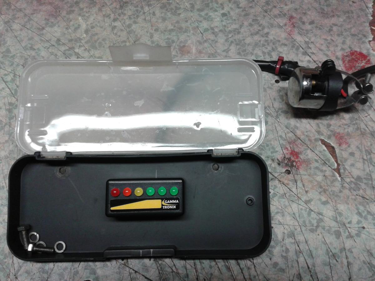

Your tale has brought some memories back. I had similar electrical woes a few back on my YX600, intermittent dying of the elkectrcal system. Got nowhere with it for weeks, so decide to install something along a similar lines to yourself., so I had real time knowledge of what was happening. Mounted on the handlebars, inside a school pencil case. It worked well too. Still got it in the man cave.
Turned out to be intermittent failure of the alternator. Had to destroy the old one to get it out, luckily got a replacement too
