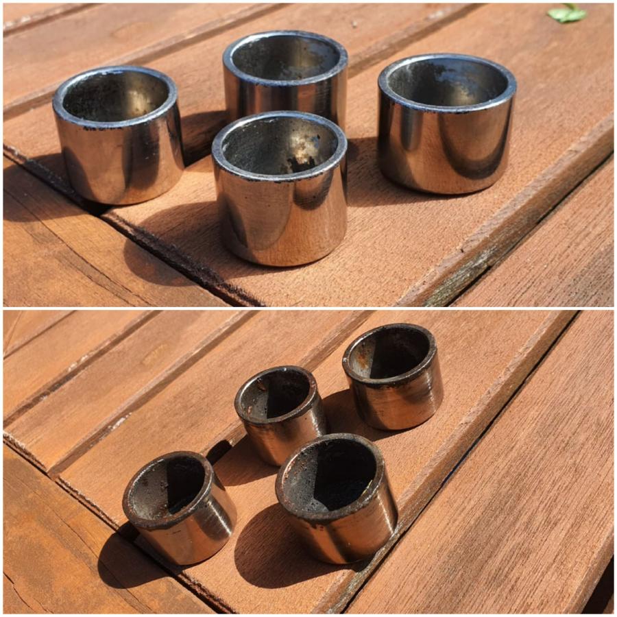

Fitted a pair of rear axle crash bungs. Hope I don't end up using them :eek :eek .
Before and after an hour or two with Autosol!
The pipes are now back on the bike, but I didn't take a pic of that Sad
(At some time I've *really* got to get around to trying that experiment with the effects of Autosol vs Harpic on corrosion resistance...)
