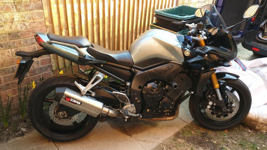

Fitted anew screen, tail tidy and LED indicators!

(02-05-20, 01:30 PM)Fazian link Wrote: Fitted anew screen, tail tidy and LED indicators!
:useless

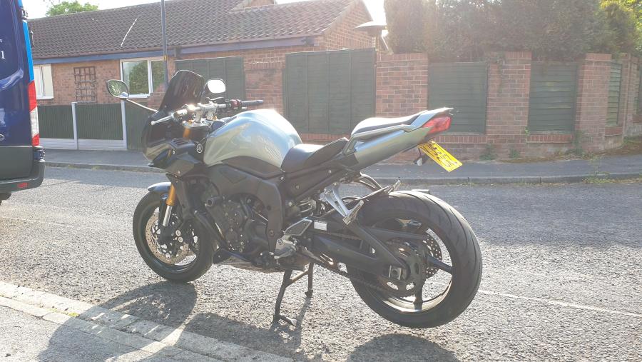

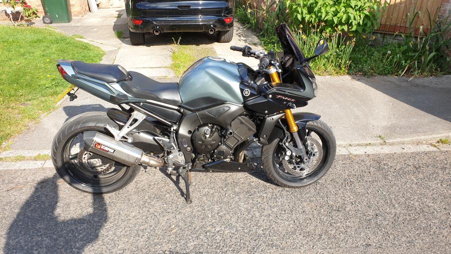

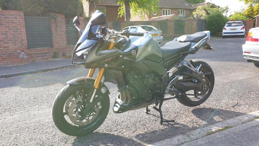

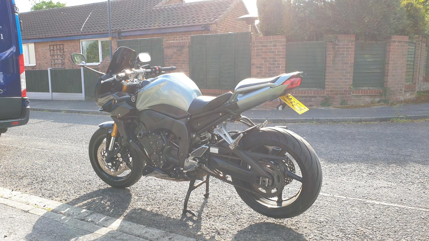

(03-05-20, 08:41 PM)coffee link Wrote: [quote author=Fazian link=topic=6412.msg313783#msg313783 date=1588422637]
Oh go on then  :rolleyes  just fitted the belly pan too  Big Grin
Before and after pics.
:useless
Very nice, :thumbup
