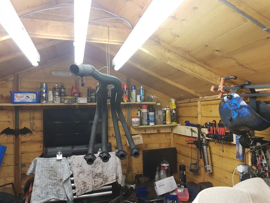

Giving the original downpipes a fresh coat of VHT black  Big Grin
Set Fazer's to stun
Wow! Nice job, very smart.
I have fitted S/Steel to my FZS 600, but I have to admit the matt black ones do look better.
(15-03-18, 11:08 AM)matt7chunk link Wrote: Giving the original downpipes a fresh coat of VHT black  Big Grin
Honestly thought you had a Batarang on the wall then ?

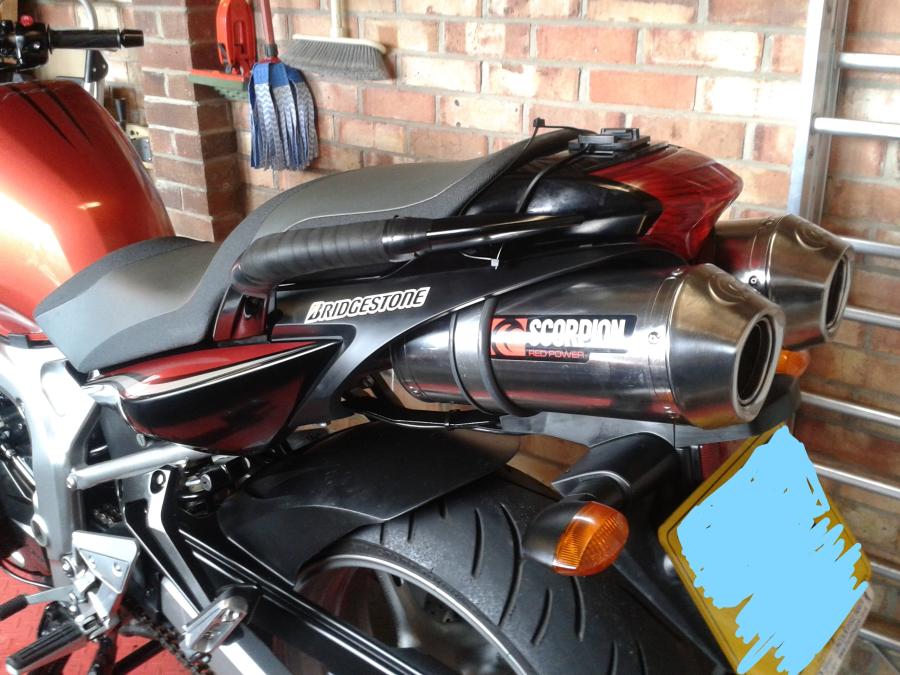

All on. Including a dcat pipe. Tight fit between the 2 to 1 and the link pipe, had to fit them together in a vice, and make up a bkt as mounting holes not quite in alignment
.wlmp   Scorps.wlmp (Size: 2.63 KB / Downloads: 4)
(16-03-18, 04:05 PM)agricola link Wrote: All on. Including a dcat pipe. Tight fit between the 2 to 1 and the link pipe, had to fit them together in a vice, and make up a bkt as mounting holes not quite in alignment
WD but we still need a picture or three.  :lol

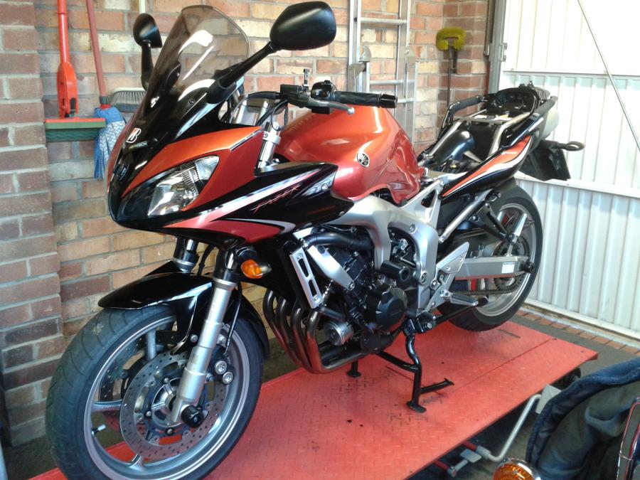

Okay. You can see the bracket I hd to make to marry up the decat pipe to the fixing point. Piece of 6mmx25mm plate, nicely radiused, 2 holes 25mm centres, one tapped M8 and the other 8mm clearance, just behind the fluid pot
A nice pair
Cool, cheers for the pics, looks like you have done a neat job on the fixing bracket + love the colour of the bike,  :thumbup
Those two new Zonkers hanging out the back look pretty neat to.
